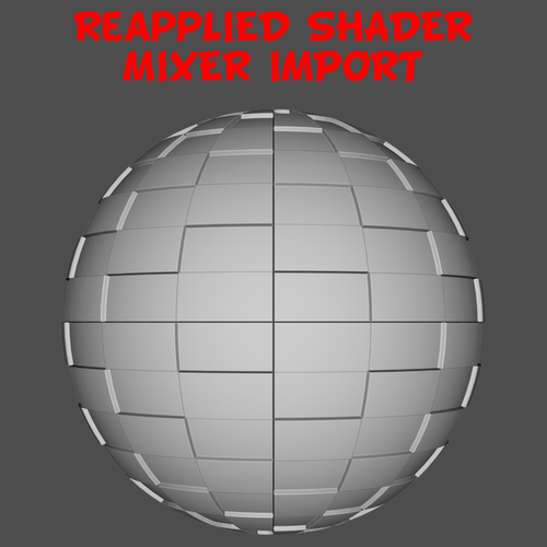

Hi,
I thought I was doing pretty good with the whole shader mixer beast, but when I applied a displacement image that had an obvious up and down with my new shader network, I quickly noticed it was inverted. So I spent hours stripping out parts to try and figure out what was happening. After four or five frustrating hours I finally tried just starting a new scene, making a 0.1 M sphere and applying a simple checkerboard displacement. Nothing else. I imported it into shader mixer and then reapplied it to the object without making a single modification and BOOM! -- inverted displacement.
I realize shader mixer can be a bit of a black art, but why is it screwing up its own imported network? Is this a bug? A known "feature"? Or am I really that clueless?!?
When I inverted the image map I was using, that fixed it in the reapplied texture, so obviously I could add some bricks to just invert my displacement maps, but that definitely feels like a band aid, not a real solution. Does this happen to anyone else? would anybody try it and see if it is just the universe picking on me, please? :-S
I am including four pictures that should show what is happening. The first is the original render with the default shader. The second is the imported and reapplied texture on the same sphere. The third is two identical spheres, one with the default shader and one with the shader mixer import applied (you can see they are exact inverses). The last is the shader network that I imported.
Thanks!
800 x 800 - 73K
800 x 800 - 287K
800 x 800 - 290K
800 x 800 - 286K

    wow. I figured I'd give it a guess. I don't know how many times I put in a Displacement map, and forget to move the slider from 0% up to 100% (In the simple tab-thing in Studio).
    I figured it may have been something like that. If the thing is swapping the (Sign-bit) all on it's own to give you a negative max and a positive min, then I would say It's more then just a bug. Someone else might spot something simple tho. That jumper-wire-mess-thing is way over my head.

    The ShaderMixer algorithm that is used to mimic the default surface shader has a few bugs in it, which is why it's not advisable to use the "import from scene" function, only time I use it is to look at another ShaderMixer shader. Displacement min/max have been switched and relabeled so instead of negative disp you get positive and vice versa, reflections are also screwed in that any map is roughly 160 degrees off and doesn't have the correct "distortions".
    The bugs have been there since the SM first appeared in DS3, so don't go expecting them to be fixed, if you intend to use the SM then you need to learn to build from scratch.
