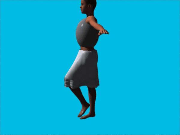

Earlier in the year I tried in vain to animate physics clothing. At the very end of my attempts I tried exporting some of the cloth simulations as OBJ files which I used to make morphs targets. The morphs in the clothing corresponded with keyframes of the figure's movement.
Before I waffle on further, my question is: could a plugin be created to speed up the process?
Now I'll waffle on as clearly as I can! The gif attached is for reference.
Suppose a figure moves as shown in the gif. If one overall physics simulation of draping cloth was carried out while those movements were being made, the leg would pass through the clothing several times.
But if a SEPARATE simulation for EACH MAIN keyframe is carried out, the cloth will drape effectively over the limbs at each of those points. Each keyframe needs to be a 'stand alone' pose - the limbs can't be moving either into or out of the pose while the simulation takes place.
If that is done (as I did to make the gif) then animated physics clothing can be achieved to a small degree.

Lastly, open the original project and add the clothing with its morphs to the figure. As you move along the timeline just slide each morph on and off, one by one. That's how the attached gif was done.

640 x 480 - 5M
