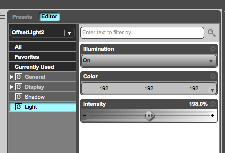

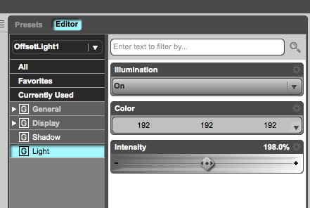

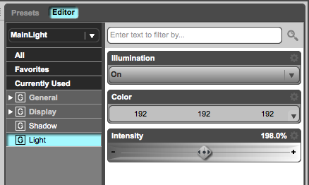

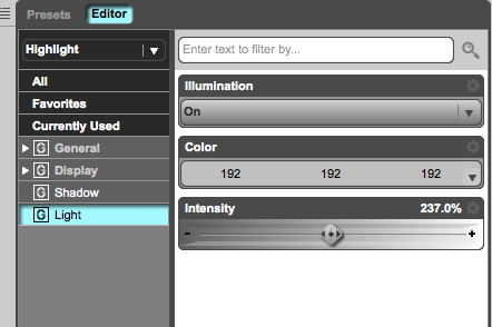

During render I get this message:
Error Message during Render
I've only just loaded G2, Loaded the Lights and Material settings from the Photo kit and all I get is blown out lights...

    The error message is not a problem, as it says the shader is old and needed to be recompiled to work with current render version. The intensity values are way to high, try knocking them back to about half their current values. Set the two OffsetLight(s) Illumination to Diffuse only and the Highlight light to Specular only.

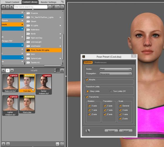

  • LindseyLindsey Posts: 2,017
    edited June 2014
    ahh.. Gamma correction was the key! Thanks for the suggestion, evilded777. I can see moving the gamma slider is going to give results as shown in the promo renders.
    In the light preset folder, there is a Cool.dsa and Warm.dsa preset that is flagged with a Material(s) tag. Hold down the Ctrl key and click on either one and it brings up the Pose Control panel !!?
    There is no transforms encoded into the Cool/Warm preset, only colors. You don't have to hold the Ctrl key when you want to use them on any of the lights.
    The Ctrl key is used on the Scene tab to select multiple lights so you can apply the preset once to change the colors of multiple lights.
    As for the gamma correction/settings, the readme did mention that these lights and MATs are meant to be used with gamma correction enabled at a gain/gamma of 1.0/2.2. Here's the link for you convenience - http://docs.daz3d.com/doku.php/public/read_me/index/19202/start
    Thanks for the clarification Wowie. I didn't realize lights can be adjusted with a pose file and the materials tag and icon image was throwing me off and I was trying to apply it to the figure materials. Will make a point to go over the readme, which I had hastily read.

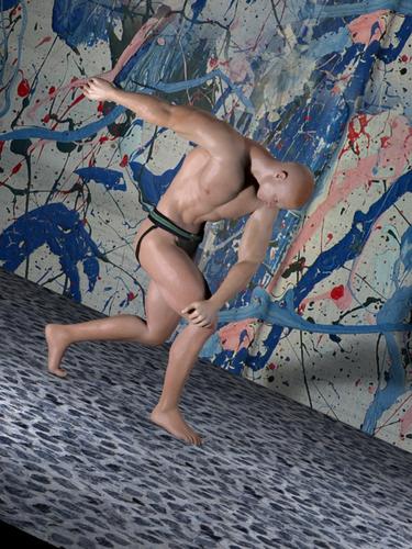

    My M4 Karass on Beautiful Bends M4.
    A little on the glossy side, but it worked for the subject matter.
    600 x 800 - 481K
  • evilded777evilded777 Posts: 2,551
    And applying a preset and then changing texture maps does seem to solve the transparency issues I was seeing.
