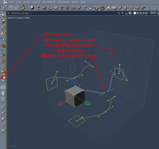

    Some additional information:
    Using the Quad View for adjusting motion path points probably makes the most sense. However, they can also be successfully positioned by using the Working Box control.
    By choosing on which working box plane a motion path point will be dragged, you can control the position while using a perspective view camera.
    Additionally, while the working box projections of a motion path can't be manipulated, the projections of "objects" can be moved.
    The Carrara 7 manual is still accurate in this respect.
