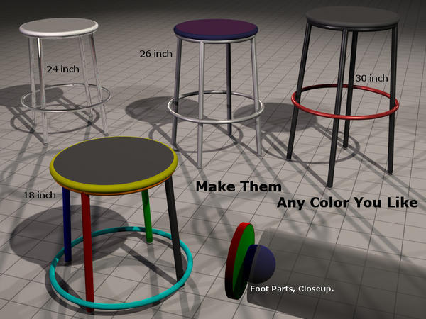

    edited June 2014
    just like my 1940s style machine shop stool. Tho it has a base gray color for the parts, no maps or other settings were used. So Anyone can make them the color or texture they like.
    Tho I'm thinking the things may fly off the virtual shelf faster if I can figure out how to save the color presets separately as described. I haven't actually looked into it, yet.
    I'm still waiting for someone to say the zip works or I missed something, lol.

    That's great. And that stool can be any sort of stool. As long as it's got a round seat, anyway. :lol:
