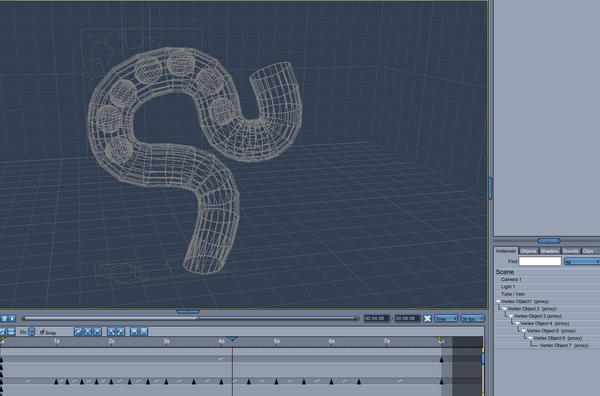

  • 3DAGE3DAGE Posts: 3,315
    You should be able to set up a scene using some proxy physics objects, to give you the motion, then use tracking to have the rigged model (bones) follow each of the tracked proxies.
    See quick Scene file... (using Bullet physics in C 8.5) ..
    https://dl.dropboxusercontent.com/u/7907045/C85_Physics_tube_drag.car
    Bullet physics can work with constraints, and doesn't need bones, you just need to create a simple parent / child hierarchy.
    The First Proxy (main parent) uses key-framed motion, to animate it's movement through the tube.(manual key-frame animation)
    the other proxy objects (children) all use Physics motion, and have a Ball-Joint constraint, with the Physics effects set to no bounce / no friction. and since they're parented to the main parent proxy, they follow it through the tube.
    Turning off the default Scene / Physics / Gravity,. also helps,. a lot.
    if you need gravity,. use a direction force, as the strength of that can be animated as needed.
    Once you have that physics motion for each proxy object, then you can apply a tracking modifier to the bones in your rigged Catheter model, and tell each bone to track the proxies. and Hide the Proxy objects for rendering
    Note: this is a medium scale scene,. done quickly,. your scene may differ ;)
    Hope it helps. :)
