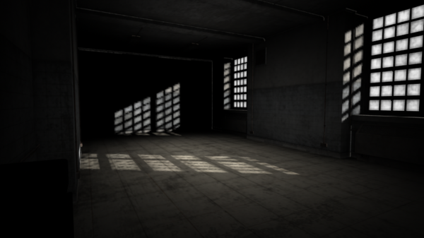

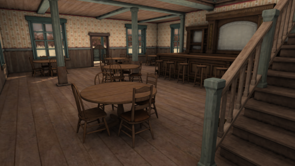

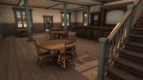

    Is something like this what you're after?
    If it is, what I did is use an AAL on diffuse only at 100% intensity and set the radius to 0 (setting it to 0 turns it to a global fill). Then I added an Advanced Distant Light at about 175%+ intensity and left it as 'on'. I also changed the color to a soft yellow. The AAL acts as a room fill, while the higher intensity distant gives that sunlight effect.
    With the distant, I also set it in the sky at a downward angle, and then use y-rotate to place it to whatever windows I want the light shining through.

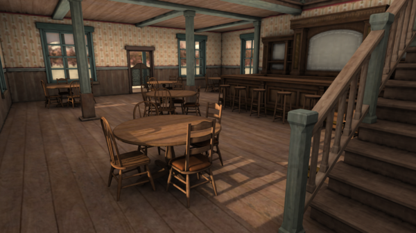

    edited June 2014
    Here's one I did with the same AAL and Advanced Distant setup. The difference is that the AAL is set to Light Radius: 5, Falloff 100%, and Intensity is down to 50%. You get similar results using the UE GI Bounce except the render times hit the roof depending on your quality settings.
