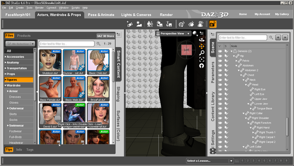

    And apparently D5 loads as Genesis 2. Thus I think it is yet another G1 to G2 Auto-fit Goof. The socks poke threw the back calf of the pant legs.
    David 5 is a morph of the original Genesis figure. The Georgian clothing made by Wilmap which is free on ShareCG is made for the base Genesis figure, so it should work without any reason to use Autofit.
    When you load David 5, it should load the Base Genesis figure, and NOT Genesis 2 Male.
    Oops, that "2" is not that, lol.

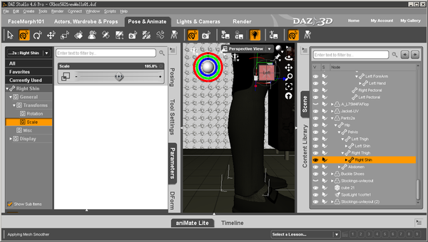

    In any case, the scaling for the leg is limited. bringing the scale up (on just the "Shin") to fix the poke-threw, messes with the pant leg length. Bunch-up on top of the foot.
    There doesn't appear to be independent XYZ scaling controls that I can get to.
    1226 x 695 - 167K
    If you click on the Parameters pane drop down menu, select 'Show Hidden Properties' and that should get you access to each one of the Scale Axis, X, Y and Z.

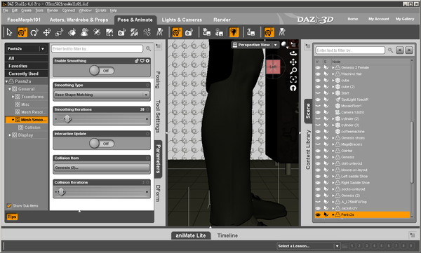

    All I had to do was turn Off "Mesh Smoothing", and the pant leg snapped away from D5 the exact amount needed.
    What's the ketch with doing that in the future with other pose positions?
    I seldom use Mesh Smoothing, unless the item looks like it really needs it.
    In that case then, it is curious it was on by default.
    The switch top left in my screen-cap is called "Enable Smoothing". It is disabled in the screen-cap.
    thank you so much. It has been a very long day, I can get some shut-eye now.
    1315 x 791 - 221K
