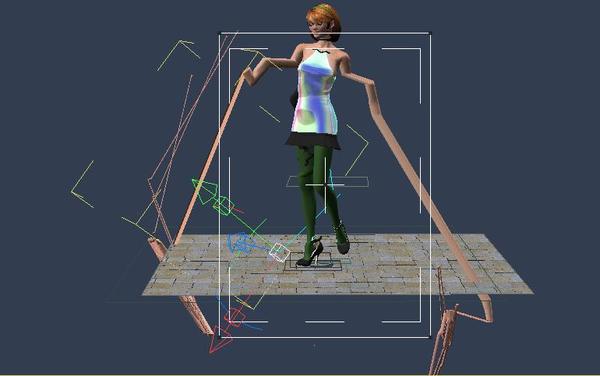

I have saved figures that I use for animation, or I try, anyway, but sometimes when I load the figures, there's some keyframes a second or two out that I've long forgotten about. Now, I could just delete them and be on my way, but when I do that, the rig blows up and looks like Mr. Fantastic on a nasty hallucinogen.
This happens on any figure that I load, I've tested with V4 and A3 along with some animals, and on Carrara 7 on Windows 8.1. defragged hard drive, more than enough memory, spyware cleaned, graphics drivers top of the line.
The culprit seems to be deleting later keyframes after saving and reloading and playing with the zero second keyframe.
Zero figure pose on zero second after deletion reverts back to T stance, but the rig is still broken. Any movement I do goes back to the Mr. Fantastic analogy.
How can I fix this?
What is doing this?

770 x 483 - 48K

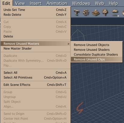

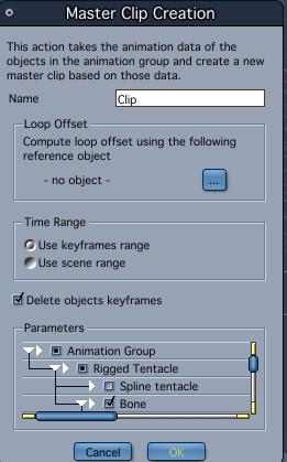

    A very easy way to get rid of unwanted keyframes on a figure or Animation Group is to create an NLA clip and select the, Delete Keyframes option. If you don't want the clip, simply delete the clip by either selecting it and deleting it, or going to Edit--> Remove Unused Masters--> Remove Unused Clips.

    Select odd non-zero keyframes, create master clip, check delete object keyframes, clear unused clips, delete odd non-zero keyframes--keyframes still present!
