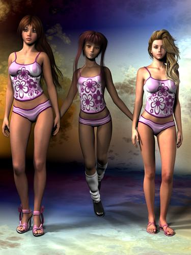

    The answer, like everything unfortunately, is 'It depends...'
    You can convert from 3rd Generation figures to Genesis, and if the conversion works well enough for you, you'll be happy to know that converting it from Genesis to Genesis 2 works pretty cleanly.
    There are a few problems to look out for. Under-breast crunch/collapse is one of the most annoying, and while it's less common now-a-days with Gen4 conversions, it's a staple of Gen3-Genesis conversions unfortunately. Also things that were straight edges often get warped as they try to follow the lines around a character. Usually this isn't too bad.
    Attached is an image of Jordan's (an A3 character) top and pants converted to Genesis, then up-converted to G2F. The pants were autofit to Genesis, worked well enough, and then autofit to G2F. The top I autofit, didn't like how it came out, and tried again with the transfer utility. In the end, it didn't really do any better. I then used plain autofit to take it from Genesis to G2F.
    The characters, left to right, are Genesis-based (Wednesday), A3-based (Jordan), and G2F-based (Ginger). Ignore the footwear, they just seemed to need it...
