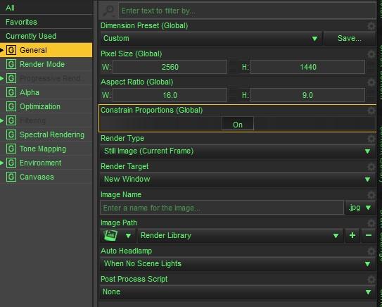

    There are two things to check.
    If you have Constrain Proportions set to On, then your proportions will be constrained by your aspect ratio preset at the top.  If you want to wing it, then  you need to change that to Off, but I usually change the aspect ratio.

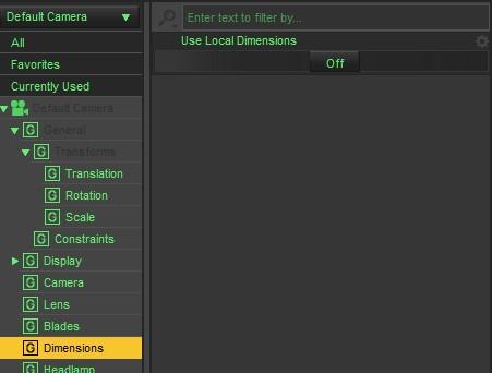

    Some products that come with camera presets use local settings for the cameras instead of whatever you put in Render Settings.  That's probably not the case here, but it's something to check when your camera seems to have it's own opinion about how your render should look.

    Check that your camera has Dimensions > Use Local Dimensions set to Off.  Otherwise the camera will use its own dimensions rather than the dimensions in the Render Settings pane.

    The Aspect Ratio at 2000x2000 is the same as 2x2 which is square. You don't use pixel sizes there. The sizes should be 1x1, 2x2, 4x4 etc. square using the pixel sizes from the settings in Pixel Size. So 1500x 1500 pixels or 2000x200 pixels gives the same size box only the number of pixels making up that box changes. To change the width of the box you need to make the Aspect ratio size for the Width to a greater size than the height, e.g 4x3 so to widen the box to that aspect ratio wold make the image 2000x1500. If the idea is to have the character still in that corner with more space to the right but keeping the square aspect ratio then you will need to pull the camera back and move him back into the corner.
