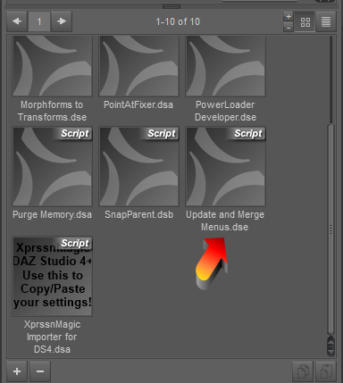

    Try this Utility Script first...
    It comes in the Script folder.
    384 x 429 - 29K
