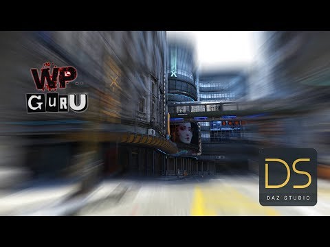

    Are you looking for something like this?
  • I found a video which gave a decent tutorial.  Unfortunately, just after I got the concepts to work, I got a BSOD and haven't been able to find the specific tutorial again.  I was impressed by WP guru's videos, since he breaks the mold and actually shows all steps and gives enough time for the viewer to see what he's doing - he doesn't just say "snarfle the garthock" and jump right in to the next step.  I really prefer to give due credit when someone creates a good tutorial.
    What I was looking for is camera orbit functions, not fly-through.  The two share some techniques but aren't the same by a long shot.  Only one camera is needed with this method.
