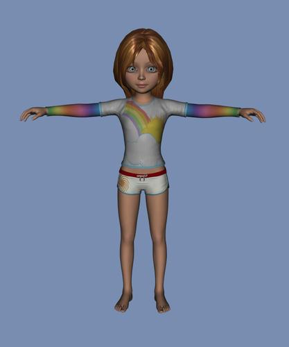

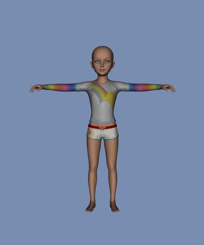

    If i understand what you're doing, it sounds like you are replacing one character with another. Let's say I wanted to combine the three characters you mentioned, I would go about it like this. I would add basic child to the scene, select it, then go to the Shaping pane. then I would turn down the slider for child to about 33% (depending on the creator, the slider would either go to 100 or 1 - either represents 100%)
    First picture. basic child at 100% and at 33%.
    Then I would select "All" under Shaping and type Mavka in the Search slot. This should show the slider for the Mavka morph which I would set to 33% (picture 2)
    Then I would repeat this for Sadie. (picture 3) and now you have a Genesis 1 figure that is one-third each character. And since she's a little girl, I gave her one of Sadie's Hairstylez.
    Hope this helps.

  • HyJinxHyJinx Posts: 172
    tjohn said:
    Hi, BD!
    Hope this helps.
    Thank You TJ!! You are amazing! I really appreciate you taking the time to provide a visual, you have no idea how helpful that is.
