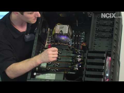

    Get a CoolerMaster HafX - http://us.coolermaster.com/product/Detail/case/haf-series/haf-x.html - It has all the room you need!
    Thank you Mattymanx. I saw that case earlier on. It's one of the ones I mentioned that are out of stock everywhere.
    I do like it. It has so many external drive bays I could use some as storage, not of data but of extra drives.
    Maybe it's no longer produced, hence out of stock. The video review is from May of 2010.
    I hope you can still get one, the Cooler Master website does not show it as being discontinued.  And dont mind the date of the video, the hardware he mentions maybe older but the sizes are no different then current large cards and hdds.  I have two Zotac AMP Extreme 980TIs in my HafX and the Noctua NHD-15 right above it (with the fans blowing the air out the top) and everything fits with plenty of room left over.
