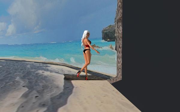

    soon i'll post the script which was used to re-UV-Map a 100ftx100ft primitive plane so that is accepts spherical panoramas
    the big advantage of having a ground plane like this is that Amy's shadows can be cast on it !
    instead of having her float 100 ft in the air
    and, you can move the camera away from the center of the sphere and the ground will NOT seem to slide under her feet
    the moderately high polygon count for the floor is needed to avoid warpings
    the script that remaps the ground will also be usable for cubes and cylinders and in fact any shape !
    many free objects found on the net have unusable UV maps, and a spherical UV mapping often gets you acceptable results
    if you're looking for UV remappers, dont miss the mcjBoxUV script found here : http://www.daz3d.com/forums/discussion/36930/

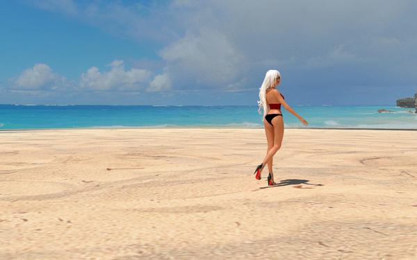

    note that the beach would look more credible if you spent a few minutes ( well an hour maybe )erasing the trees and their shadows from the image map and replaced them with "real" ones

    see? shadows on the floor
    the 100x100ft spherical-compatible plane is not in its final state but it works as seen below
    i added it to the spherical web page : https://sites.google.com/site/mcasualsdazscripts4/spherical
    under the name ground_XZ_100ft_Y165cm it's a zipped .obj
    i loaded it in daz with an import scale of 100%
    i moved it up to 592.84
    the mcjSphBall e was also imported at 100% then scaled 25% rotated 270 degrees
    the floor texture tiling is a bit bizarre : -1 vertical tiles ... the final version wont require t his
    the dome texture was set to -1 Horizontal tiles
    in Blender i set the dome emissive with the EXR version of the map ( the HDR was completely blurred tsk tsk )
    i was lucky, the strength-3 sun light brought the floor luminosity to the same level as the dome
    in the dome's object properties i set the shadows off in the "ray visibility" sub-section
    and i blackened the external environment
    so Amy is lighted by the dome's texture and the sunlight

    by increasing the mesh resolution of the sphere from
    64x32 to 128x64 we reduce distortion near the poles
    the defects seen here were part of the image itself
    the second image map was perfect
    fig 3 - doing through a test scene to see if the upcoming mcjSphericalUV script has what it takes for shadow-catching
    fig 4 pretty seamless ! the 2 primitive planes blend in with the gigantenormous environment sphere
