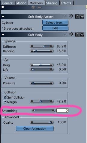

    I was digging a little deeper 'cause I feel like I have seen this problem described before and found a possible solution: maybe try setting Smoothing to '0' in the Soft Body Modifier.
    You can simulate with a higher smoothing number, but when it comes to render time for animation, set it to zero, apparaently there is a bug? I don't know because it worked from my end with smoothing set higher, but I'm on a Mac, maybe it was a Windows bug?
    Might be worth a try.

    Setting the Smoothing to 0 did the trick. Thanks for that tip!

    Thanks Dartanbeck, but 'tip of the hat' really goes to FENgari, and later in the thread confirmed by WendyLuvsCatz: smiley yes
    https://www.daz3d.com/forums/discussion/comment/4604776/#Comment_4604776
    "I've been having this particular problem recently and found that by setting the SoftBody 'Smoothing' parameter to 0 clears the fault and the cloth will animate and render as expected using the Photorealistic render. I completed a quick experiment involving a cloth simulation with Smoothing set to 1, tried to render - no go, then reduced this setting to 0 and it rendered??? I haven't tried the reverse; ie complete a simulation with 0 as the setting and then trying to render with it set on a higher value... I just thought I'd share that with you."
