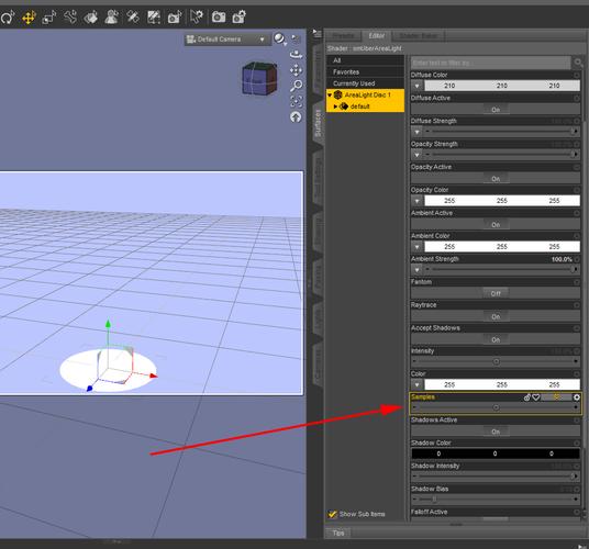

  • SzarkSzark Posts: 10,634
    Select the Area light/s in the Scene Pane and then pop in to the Surfaces Pane. Remember if you read my Area Light tutorial these are surface shader lights so their parameters will be in the Surfaces Pane. ;)

    I'm sorry for being slow, but... That looks nothing like my panes, Szark. I can add various panes to either side of my gui layout, but the only thing called surfaces is "Surfaces (Color)" and there are no options there for lights.
    I'm using Daz Studio v. 4.6.3.50 Pro Edition, if that matters?
    edited June 2014
    Yes you need to select the light/s before any parameters will show up in Surfaces (Colour) Pane which is the same as My Surface Pane. I am just using a different UI layout and colour scheme.
    They should all show up in the Scene pane though so they can be selected. Don't select anything called Area Blocker (or something like that) but select the object, Sphere, pane etc that is emitting the light. It should say Area Light Sphere, pane etc. I also cannot check as I too have a; Vue render going and b; I don't have this set yet.

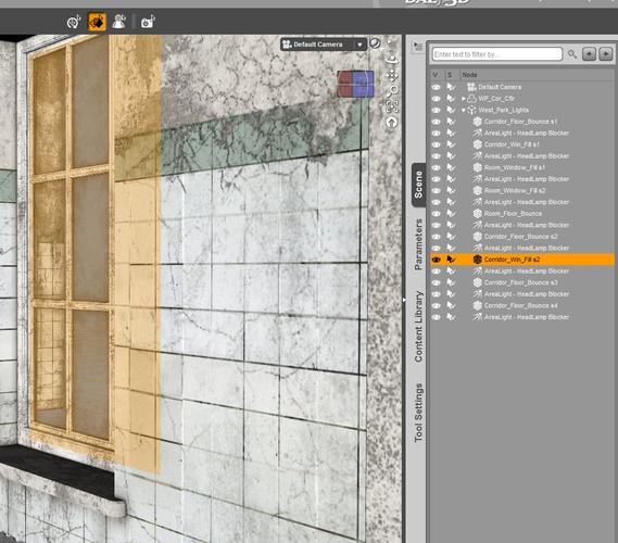

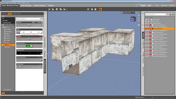

  • AndySAndyS Posts: 1,448
    OK Khoyan,
    Now attached you find a screenshot where I marked the important elements.
    On the right side I'm in the scene tab to see all items of the scene. For the West Park Set they have grouped all light items, so you have to expand that entry.
    Now you see the entries marked with a little cube. These are the important area lights. If you select one, you get all parameters in the surface reworking tab (left). Here you go to the light entry. This is the place where you can modify the intensity, the color of the light and the sample rate for the quality. In this case: higher values = higher quality.
    In the second picture you see as an example, where the light area is located. The faint yellow area corresponds to the orange selected entry in the scene tab.
    But for all rener quality parameters please keep in mind: Higher quality causes extraordinary longer render times!
    I hope that helps.

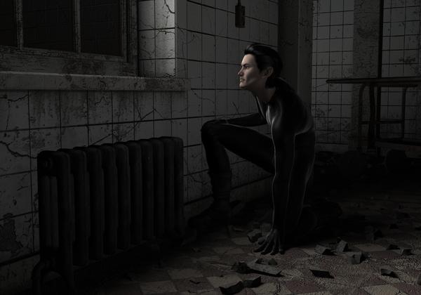

  • KhoyanKhoyan Posts: 72
    This is the result of a sample rate of 64, with shading rate at 0.20 and shadow samples to 24. I wasn't satisfied with the sample rate 32 render, but saw a clear difference. The image will be post processed in Photoshop, so this result is more than good enough for me.
    I'll run a 128 sample rate render as well just for the heck of it.
    Thank you guys so much for all your help!
    1200 x 840 - 532K
    Nice, yes looking much better.
