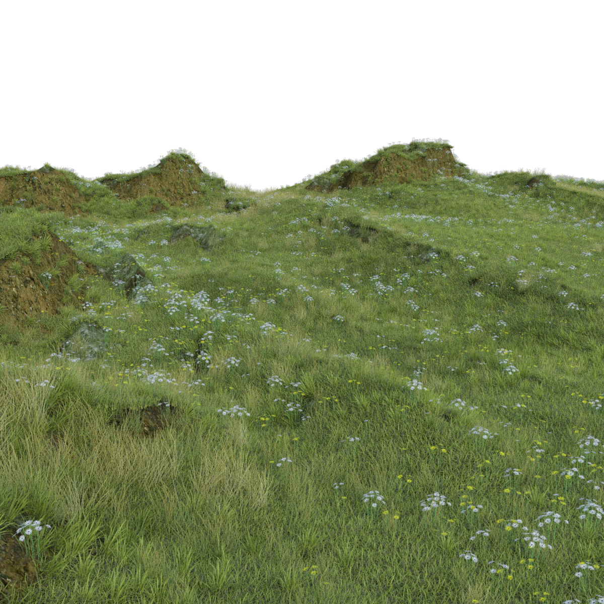

    Yeah, so what you can do is stop the render early when it's still a little bit noisy and then drop it into the denoiser app. :)
    For instance, this UltraScenery render I ran for only 30 seconds. As you can see it has a lot of noise in the grass:
    But I popped it into the DragNDrop app for the NVIDIA denoiser and that got rid of most, if not all, of the noise:
    Not too bad for 30-second render, imo. :)
    1200 x 1200 - 3M
    1200 x 1200 - 2M
    Post edited by 3Diva on
