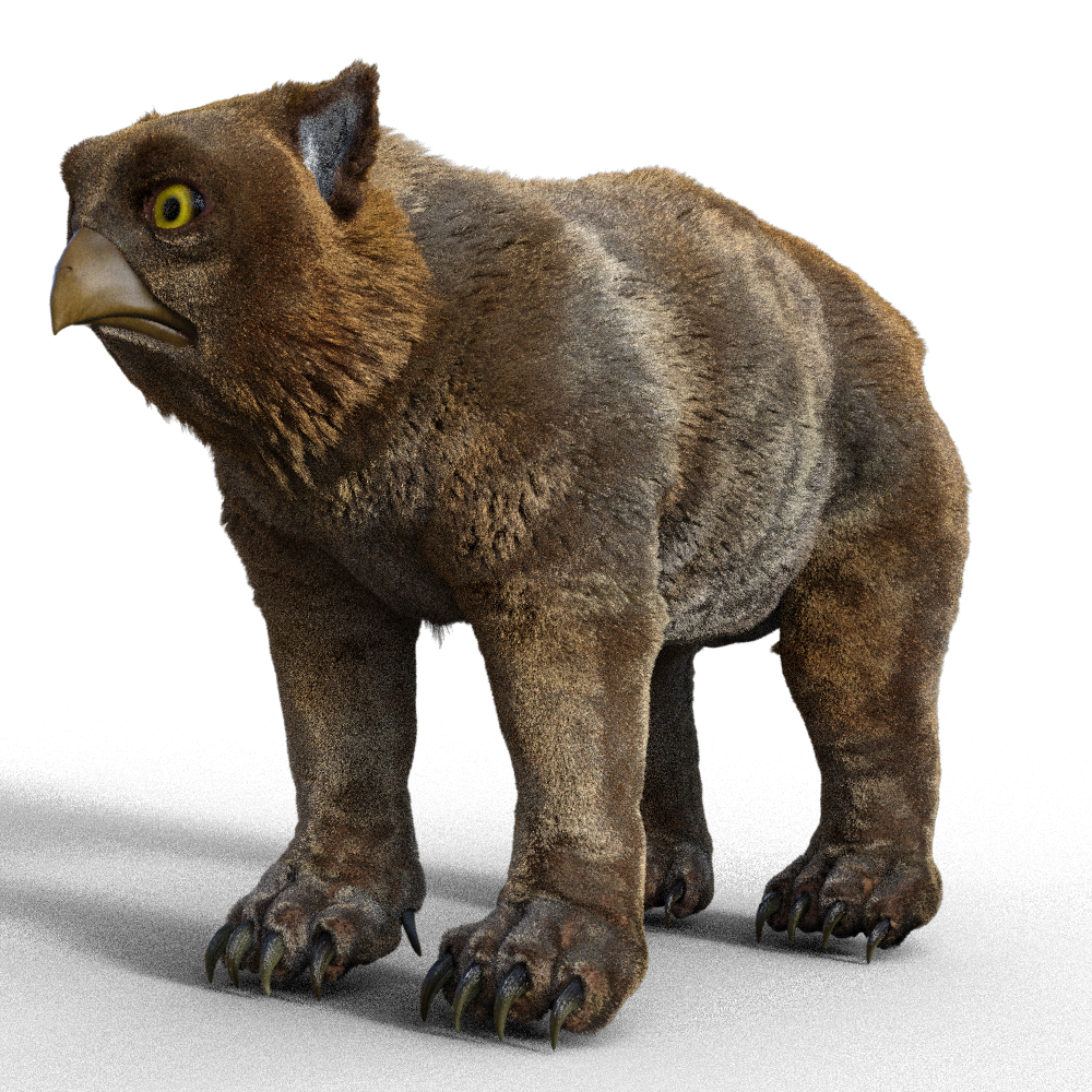

  • GordigGordig Posts: 10,805
    edited July 2020
    Here's Lechuza with Map Transferred Yellow Lab materials on the fur. It doesn't look quite right, but there are probably some other settings you could tweak to get it there.
    1000 x 1000 - 1M
    Post edited by Gordig on

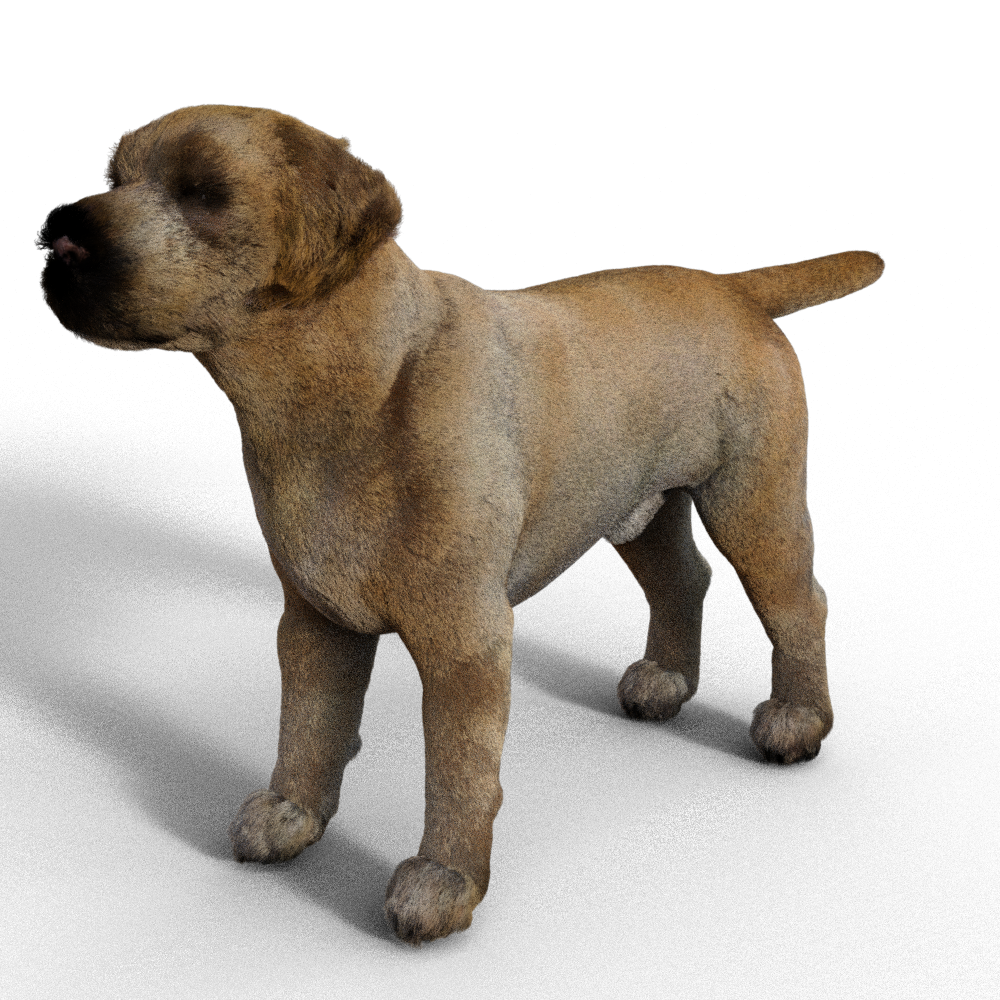

    edited July 2020
    I dialed Lechuza out, and Labrador back in, which made it clear that Lechuza may not be a good choice because the beak doesn't have fur on it. You could try editing the hair growth maps. Pooka is a better fit, because it does have full fur like a dog, although it's definitely exaggerated in some areas, especially around the nose. Here is a slightly modified Pooka fur on Labrador.
    1000 x 1000 - 1M
