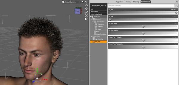

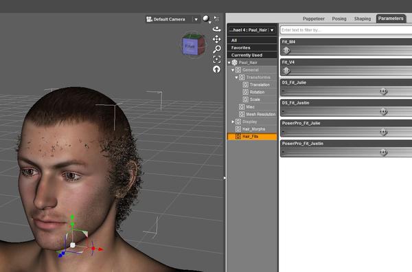

  • SimonJMSimonJM Posts: 6,102
    I probably have something by the same PA, but for sake of speed here's something I guess is similar in nature (the Paul hair, also a .hr2 prop style hair):

  • nightwolf1982nightwolf1982 Posts: 1,329
    The fit morphs are located under Transform > Elven Fits on the parameters tab and the shaping tab.
  • DirewrathDirewrath Posts: 225
    edited June 2014
    Also the morphs for the hair are located at the neck, so you have to be sure to click on the neck for the parameters to fit or shape it.
    When I loaded elven hair on my M4 in DS4 it appeared in the middle of his head, but as you cannot conform the hair like a figure you have to manually size it with the right dial. It has different figure fits so select the hair, then click on the neck and the parameters should show up in the parameters window.
