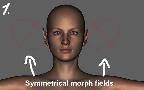

Hey everyone I hope you are having a great day! So, today I jumped right into morphing and I decided to start with something easy so I went for elf ears. But I have a problem, I can´t seem to make the other ear look just like the first one.
So my question is, any tips on how to make body parts like this symmetrical while morphing them?
I must be missing something. The morph fields should be symmetrical and I copied the parametres for the first ear to the second morph yet I am not getting the same ear.

    How are you doing this - with DForms? Did you just copy, or ddi you switch the signs on the y and z rotations (I think)?
  • ToyenToyen Posts: 2,081
    Yes I am doing this using D - formers. After I created the first field and customized the ear I simply made a new D-former, made the new field symmetrical with the first one and copied the parametres of the first morph into the second morph but the ear came out differently.
