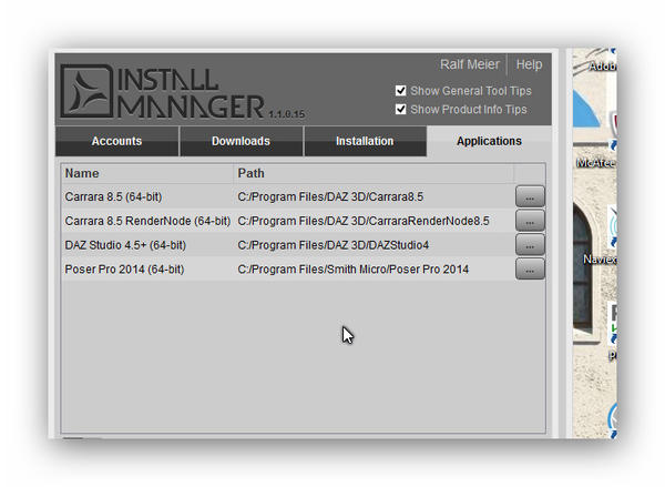

Thank you for your response.

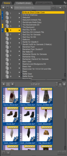

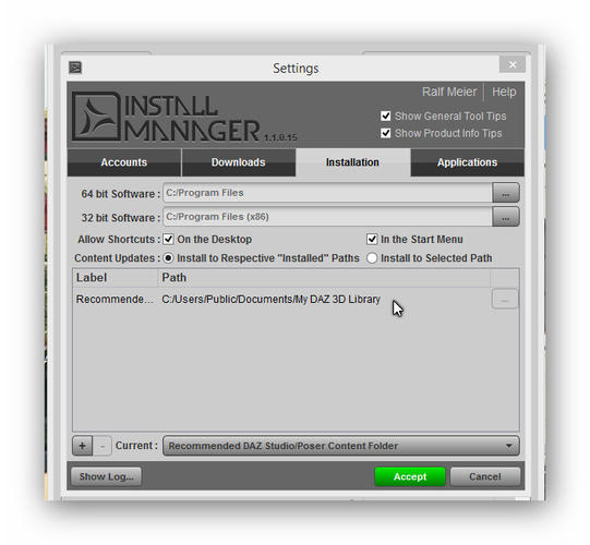

I think it is better to show you two pictures, to answer your question.
In the Content Library they are still there, but not in the presets.
All work is done by the DIM.
Greetings Ralf
I'm sorry, but I have no idea what you mean?
The two images you posted look to be correct, but they don't tell me anything about your problem.

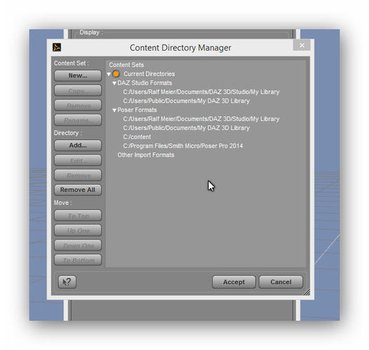

Is this the first time you have used DIM? If so, are you aware that DIM installs by default into C:\Users\Public\Documents\My DAZ 3D Library, and do you have that library listed as a DAZ Studio and Poser Formats library inside DAZ Studio? Edit > Preferences > Content Library > Content Directory Manager.

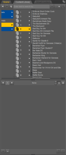

I think this picture is right for this question.
You still haven't said what Presets are missing?
Your DAZ Studio Formats seem to be correct, assuming that you have 2 DAZ Studio content folders, 'My Library' and 'My DAZ 3D Library'.
For Poser Formats, you also have C:/content, what is in that library folder? If there is DAZ Studio native content (NOT Poser) in that folder, it will not appear inside your DAZ Studio Formats in the Content Library pane. You would need to add that path to the DAZ Studio Formats as well.

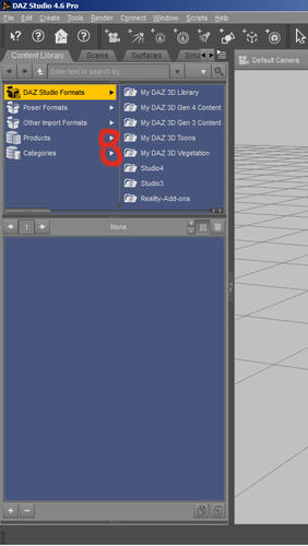

Can you show me a screenshot of your Content Library pane as shown below? If there is a small triangle next to Products and Categories, then CMS is usually running properly.

There are no trangles.

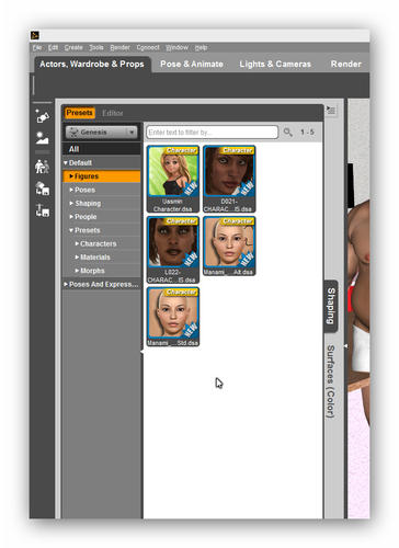

Now some presets are back, but most of them are still gone and there is no cms anymore.

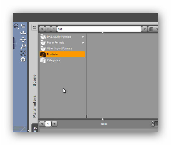

Are the triangles back in Products and Categories?
Can you post a screenshot of your Smart Content pane please?
I don't see how some of your Smart Content can be showing, but other parts are missing. If CMS is not running, there will be NO content in the Smart Content pane.
In the TaskManager is no cms running.
You have Not selected anything in Products to Show. The Base path B holds nothing, select a product to list the contents.
