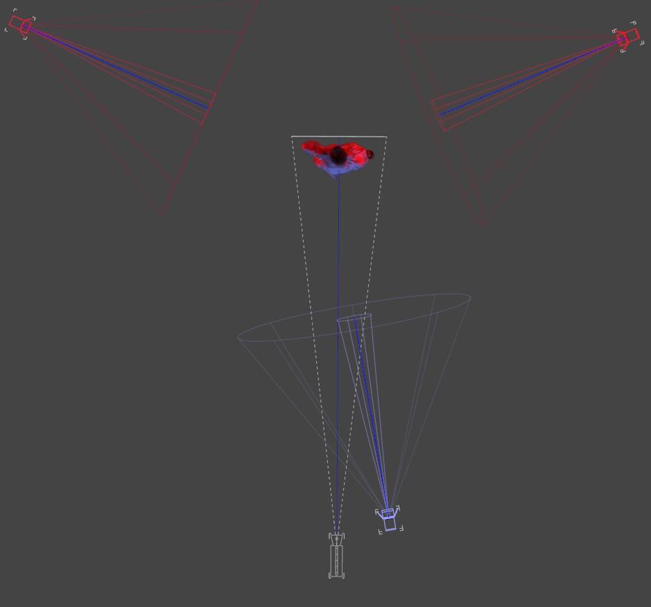

  • SevrinSevrin Posts: 6,314
    ayndrek said:
    Oh hell yeah. That's amazing! Do y'all use the PTF Neon Splash suite Wolfwood suggested, or is that handmade with the basic lighting tools?
    I just placed Daz spotlights.
    The usual way I do it is use Perspective View.  Then add a spotlight with the Active Viewport Transforms.   Your spotlight will be selected when you place it.  Then change the Light Geometry to something other than point unless you want sharp shadows.  I mostly use rectangles - the larger the height and width the softer the shadows will be.    You can change the colour here, as well.   If you want red light, you can just lower the temperature to something like 1500k or so.  Lower numbers: redder.  Higher numbers: more blue, although it doesn't really get deep blue.  You an also just change the colour using the Select Colour window.

  • ayndrekayndrek Posts: 12
    Sevrin said:
    Awesome, that's exactly the knowledge I was after. Thanks a lot for sharing this!
