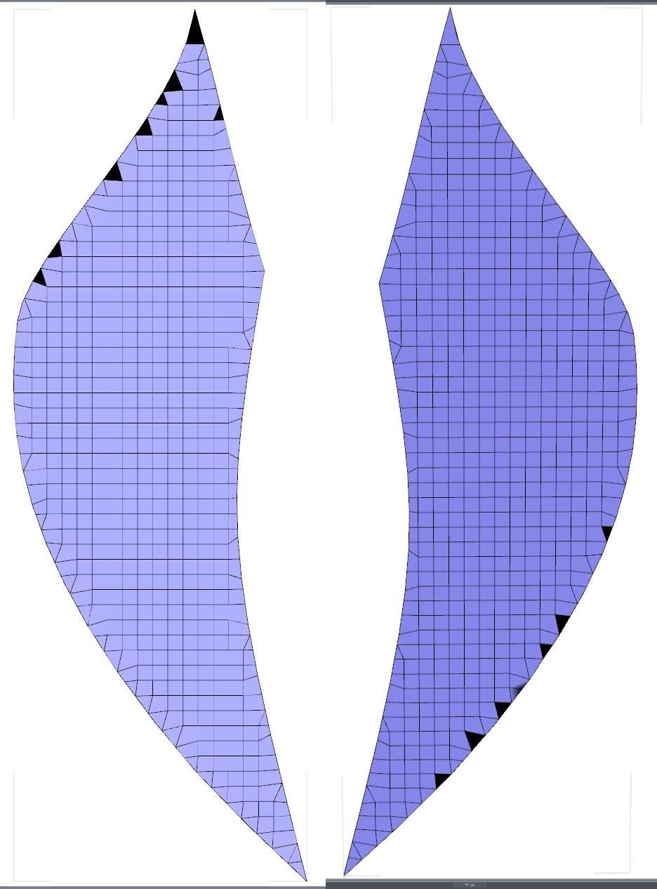

  • DaremoK3DaremoK3 Posts: 798
    edited July 2020
    I thought you fixed your problems and were all set...
    What issue are you having with your mesh that you would like me to look at?
    I can look at your Blender (.blend) mesh file or files that contain your pre and post join meshes to check for mesh problems, then we can go from there.
    PM (private message) me here, and we can set up a way for you to send me the files.
    But, your post above is a little confusing  --  A UV file is contained within an object file whether joined or not as long as you created the UV's.  Same goes for Vertex Groups - contained in object file as long as you created them  --  Both should remain upon export and written into the OBJ file..
    Just for redundancy sake, I created a wing part in Blender with the technique I believe you used and crossed checked the work in Daz Studio  --  Uncorrected mesh yielded the exact same results as you first shown with what you thought were flipped normals, but were infact viewport/render anomalies created by the concave quad polygons on the mesh borders.
    Correcting these by either making these polygons tris, or making the offending vertex slightly convex fixed the issue.
    * Technique used was as follows (may or may not be what/or part of what you did):
    1.  Created a Bezier curve flat plane shape
    2.  Converted curve object to mesh object
    3.  Added Solidify Modifier
    4.  Added Remesh Modifier
    5.  Applied both modifiers
    6.  Edit Mode -- Selected rim edges/faces and deleted them - leaving me a front and back quad meshed membrane shape (no flipping of any normals necessary)
    7.  Created Bezier Curves on wing shape border for spines -- added bevel, sized as needed, and converted to meshes
    8.  Exported as OBJ (no pre-join) with 'Selected Objects Only' checked  --  OBJ file auto-merges all objects as one object
    9.  Imported into Daz Studio  --  Came in as expected with no flipped normals or viewport issues
    Images :
    * DS viewport issues on mesh
    * Blender mesh adding color to correspond with DS issue for testing
    * Final corrected mesh with spines added (just quick work - would perfect if going to use seriously)
    936 x 1266 - 185K
    539 x 1338 - 152K
    1000 x 1200 - 147K
    Post edited by DaremoK3 on

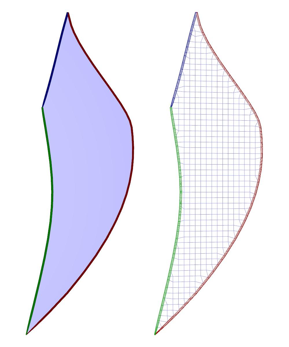

  • mirjagirlmirjagirl Posts: 85
    edited July 2020
    I will PM you, but thought an answer would also help anyone else watching this thread.
    The problem was 'fixed' on the surface.  However during rigging, my twist showed me the triangulation was a much deeper issue.
    The files I listed are my 'Flow' / backup steps.  I keep each step just in case I need to go back 1 step (or in this case 5). Less keystrokes if I don't have to disassemble for a quick fix.
    The process you listed above, I'll have to try that one day.
    I'll pm you.
    548 x 527 - 83K
    Post edited by mirjagirl on
