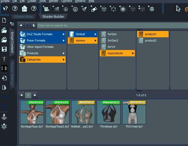

  • fixmypcmikefixmypcmike Posts: 19,713
    I prefer to use Categories to organize rather than moving the files on the hard drive, that way nothing can get broken.
  • JaderailJaderail Posts: 0
    +1 to this.
  • kitakoredazkitakoredaz Posts: 3,526
    +1 (and add "hand made product meta-data" if you like,, to see them ,in product pane of smart content)

  • SuperdogSuperdog Posts: 765
    How do I organise content using categories? I usually search for content using the folders view because the smart content view doesn't seem to show all my content.
    edited May 2014
    you can use content ribrary>categories section .:)
    It should show all items in the category whch you set "without compatiblity ",
    (or already catgorized by vendors offered with meta-data,)
    you can add multi category for one assets too.
    Then you can add sub categories as you like,, or re-categorize all assets with your original categories ,
    and sub category, if you really like the way,,
    eg you can add each vendor name category as root,, and you can copy and paste all items
    from daz offer catogries to your original categories
    ( I do not touch the daz offered Default categories though,,)
    they only change add, remove the reference to the category,, so that it never change actuall file and file path.
    But,,, about texture , image files,,we may still need to use exproler, these items can not directly show
    in daz studio,, then I need to use folders (DAZ smart Formats, or Poser Fomats) still,,though,,^^;
    Though,,, I can not keep clean , it is because I am so lazy^^;
    (but I can achieve it if I need,, then may use category,, not move actually directory)
