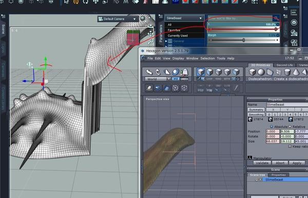

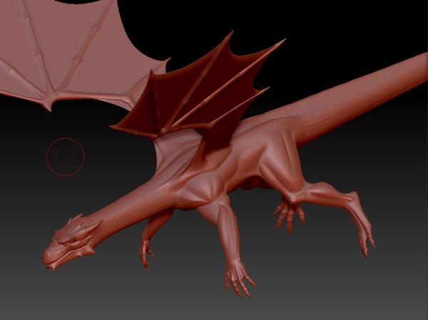

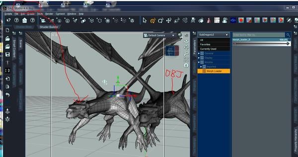

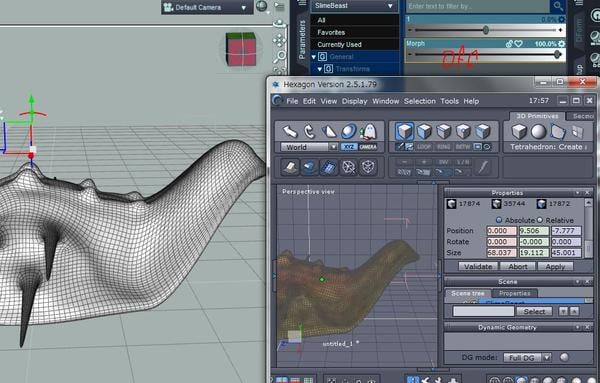

Someone please try and check to make simple morph for sub dragon LE (duf, cr2 both you like) for daz studio.
then check how it work please.
I think there should be some problem about morph loader pro (or hexagon bridge) of daz studio at current.
(or pivot point etc,, I do not know,,)
I only tweak tail part in modelor (hexagon bridge, or blender)
then try to make morph. it is rally simple,, just bend tail only, not touch anything.
but after I export the obj as morph, how I try to adjust ,,the face or other part move.
there seems no difference.

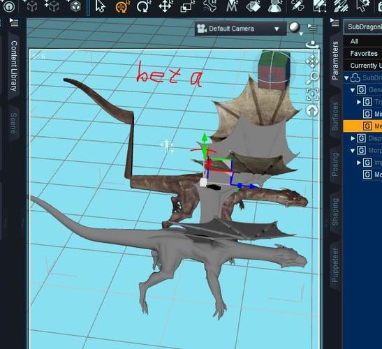

And it is really strange, even though I use same obj for morph loader Pro to test morph,
but in beta and current ver,they make different corrupted morphs.
but when I imported the modeling shape,, the shape is clean, and no problem.
which happen when I try to make morph only.
some cr2 have no problem when make morph. (eg millenium dog)
and I have not feel problem to make morph for genesis2etc
(from last week,,,, I have been made many expression individual part morphs and controller , for my character,
and I had no problem when use morph loader pro,,)
I know current ds 4.6 ver not changed about morph loader etc.
so that about some figure,, it seems not work correctly.
Is there any reason when it work or corrupt morph?
Edit) 2014/5/31 sitll test with other figures again,,
As a result
when make morph by morph loader Pro and hexagon bridge with "reverse option yes"
the rigged figure, root node "rigging (center point)" need to set as (0 0 0) .
it seems only happen about triax figure, in daz studio 4.6.3.50
(I chekced again with cr2 animals,, but they seem no problem ^^; today,, sorry)
I do not know about some figure,, even though the root rig is not 0 0 0
it work or not,, but actually subdragon LE, and some product creature
can work after I set node 0 0 0.
without it "reverse option" make corrupt morph.
we can temporally set center point (0 0 0) of root node. in joint editor manually,
or blackfeather scirpt,,, it work.
(If you need to ERC freeze after make morph, take care,,)

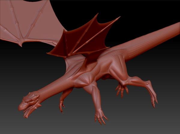

I don't have the beta installed, but can replicate both problems in the current release of Studio.
Creating a morph for the subdragonLE also makes the lower jaw rotate, some horns to grow and part of the wings to move.
I did notice that the subdragonLE loads with it's jaw and tongue bent (bend parameter not zero).
Loading the same morph with reverse deformations, solves the jaw, horn and wing problem, but then the created morph gets messed up; just like in your second pic.
Edit : forgot to mention that i used the Hexagon bridge to test this.

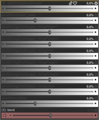

Found some hidden morphs that are dialed up when the subdragon loads in the scene.
Set all these to zero before exporting the dragon as obj, then you have the real zero pose for your modelling program.
There are three bend parameters (lower jaw, tongue1 and tongue2) and six wingmorphs (two times shoulder, forearm, finger1).
So i don't think morph loader is broken, it's just how the dragon loads.

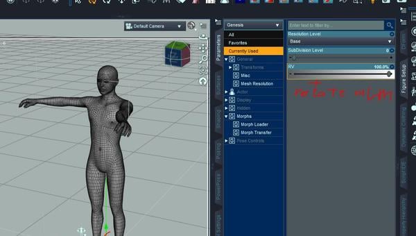

Then I check samething about genesis,,
it root node are 0 0 0
then I pose genesis arm rotate,
then send hexagon twist strange way, return with reverse defomation,, about genesis it work as I expected,,no problem,,
:roll:
