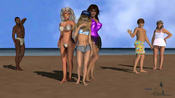

Just as the title suggests, How do you get the effect of wet denim and other "heavy" cloths? I had figured it was a simple matter of darkening the diffuse setting and bumping up the specular setting, but that didn't work. For the record, these are what I want to make look soaking wet.

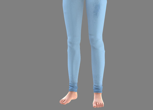

    How wet are you talking? Dripping wet or partially wet/splattered like the bottoms of these?
    Totally drenched.

    Well, the draping isn't an issue because I'm using the "Daisy Dukes" setting for the JeanZ, so there is no draping. It's just the tight short-shorts cut. My problem is I'm not getting the "shininess" I should be getting at all. Basically I want to make Tommie here (the girl in the middle), shorts and all, all wet:
