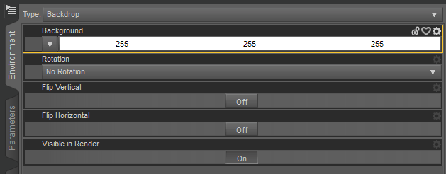

    The perspective will change when using an HDRI and panning no matter what. Maybe a backdrop is what your looking for? It won't be an HDRI, but it will not change at all as you pan the camera. Check out the Environment tab and load an image:

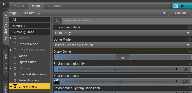

    Also, you may want to check into the "Infinite Sphere w/Ground" and "Finite Sphere w/Ground" options for the Dome Mode for HDRI:
    Among other things, this allows you to use DOF with HDRI and helps to "pin down" your 3D objects within the environment.
