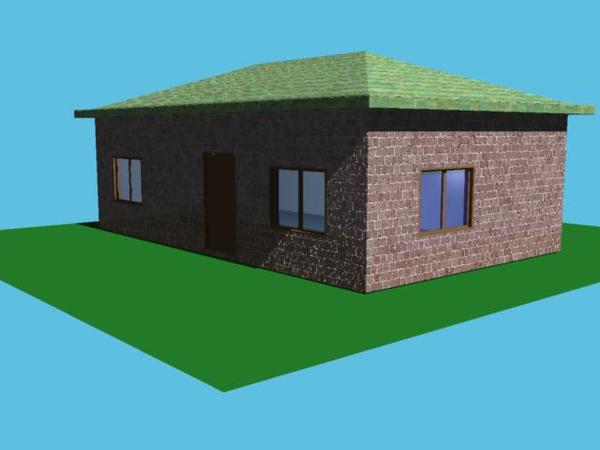

    Took just a couple of minutes to toss this together. You have control over the roof style and you can make your own windows and doors in the vertex room. You can then set sizing in Architools so you can have a floor to ceiling window, for example for a convenience store (I needed one).
    New project.
    New Architools object
    Draw four walls.
    Place windows and door spaces.
    Assemble room: load window and door.
    Back to Building and link windows and door.
    Add roof and adjust to taste.
    Assemble room: add shaders.
    Add light bulb inside building.
    Done.

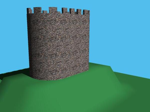

    Or a simple castle tower in a couple of minutes.
    Create room.
    Bend two walls into arcs.
    Add floor (duplicate of the first).
    Replace with crenelated wall.
    Return to Assemble room, add rocks shader. Make a quick ground in the VM and add green shader. Less than five minutes.

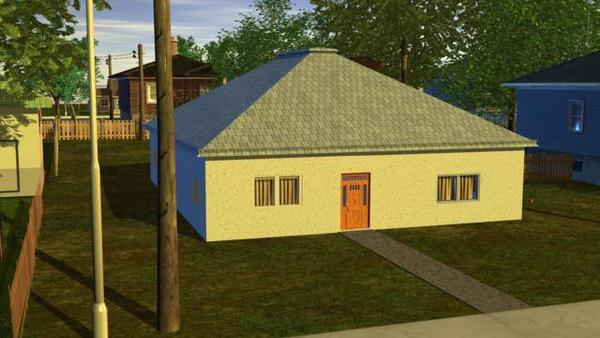

    Here's a little bungalow I built using Architools. It's not much, but it has exactly the specifications I want for the story I'm working on. Of course, there are other kits, like Maclean's Room creator, that you can use to build houses, but only houses; Architools allows you also to build apartment buildings as big and as high as you like. Plus, the Veloute procedural shaders, that you can buy separately, are astonishingly realistic and versatile.

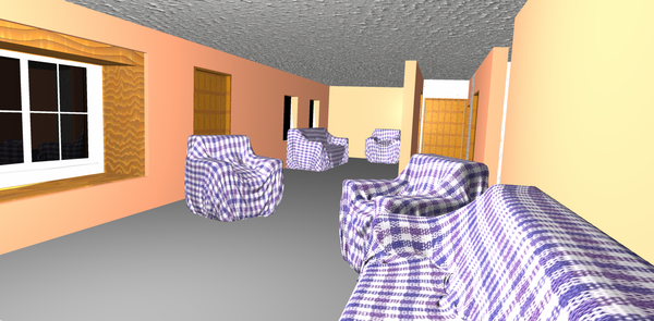

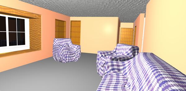

  • Dave_5690Dave_5690 Posts: 19

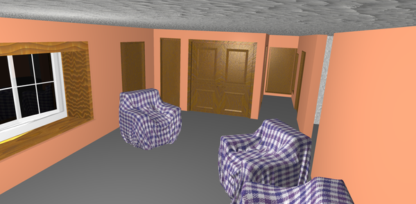

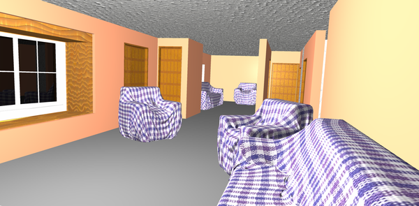

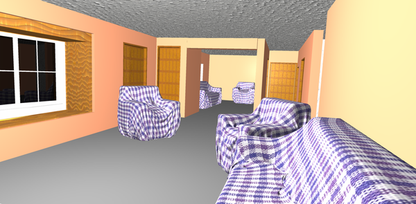

    I'm about to move into a new house, and I'm looking at taking out part (or entire) of a wall. I used architools to mock up a few alternatives to see what they'd look like. (Yes, there are probably easier ways to do this, but I wanted to try out architools).
    1920 x 943 - 2M
    1920 x 943 - 2M
    1920 x 943 - 2M
    1920 x 943 - 1M
    1920 x 943 - 1M

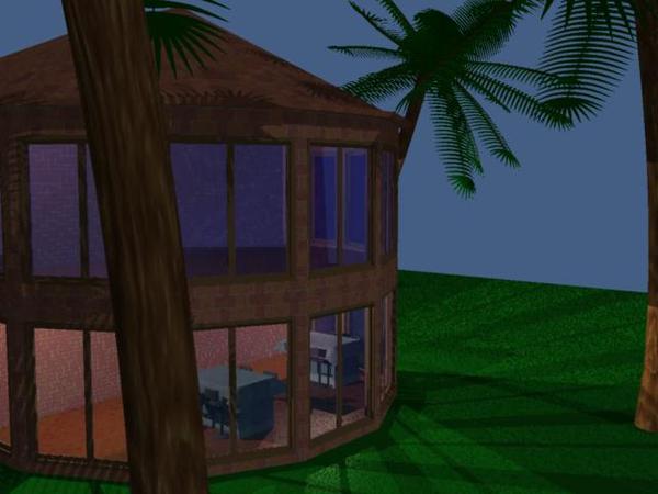

  • That Other PersonaThat Other Persona Posts: 381
    edited May 2014
    Working on curved walls and windows. So far, it's difficult to create a curved wall and get the windows to match. If, however, I create straight walls in a curve, then the windows fit fine.
    I'm trying to create a restaurant dining hall with atmosphere.
    Created the 1st level, duplicated and then created the roof. Added two light bulbs within in dining area (1F, 2F). The angle of the shot keeps reflection strong on the upper windows.
    Now I just need better furniture and a chef...
    640 x 480 - 32K

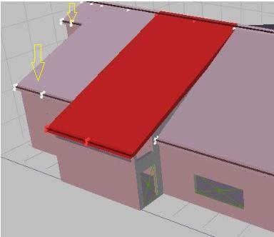

    Guys,
    Question please:-
    - How can you build such roof like the one in the tutorial in the inagoni site? I did every thing I think of to no avail. any idea?
    Many thanks for the help
    384 x 332 - 19K
    Post edited by sahebfahmi_18ba20182a on
    edited June 2014
    I haven't tried anything that complicated yet, but I will give it a shot tonight or tomorrow.
    Do you mean the entire roof for that house or just the one section?
    Edit: I am working through the roofing tutorial now... There are a lot more adjustments possible than I was aware of!
    Post edited by That Other Persona on
  • edited December 1969
    I mean that this roof has 2 main levels (as shown) ... how to do this?
    Also if you look at this building from the side, you see that the gutter on the right is now at the same level of the left one? I reckon that this roof should be made of 2 pieces,,,,, I do not know, I spent more that an hour to do but did not get it.....
    384 x 332 - 26K
    edited June 2014
    I just downloaded the model of that house (the link is at the top of the page just under the picture).
    Those are two pieces.
    The roof for that side is made up of four pieces. The other side is three for a total of seven.

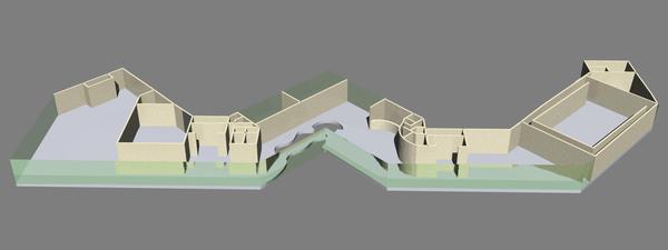

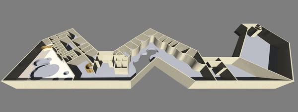

  • makmamakma Posts: 54
    edited July 2014

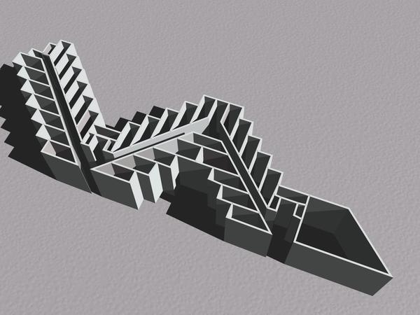

    I've used Architools for modelling different levels of a hotel. It was quick and easy task. So I can confirm it is a good tool for skeching up the ideas. Unfortunatelly when exported into vertex modeller I had same issues with walls intersections. There where vertises to be welded.
    Quick renders in C.8.1
    I like the tools and want to test it in making of a catalogue rural house from the blueprints.
    Greetings
    Marek
    2000 x 1500 - 270K
    2000 x 750 - 137K
    2000 x 750 - 138K
    2000 x 750 - 104K
