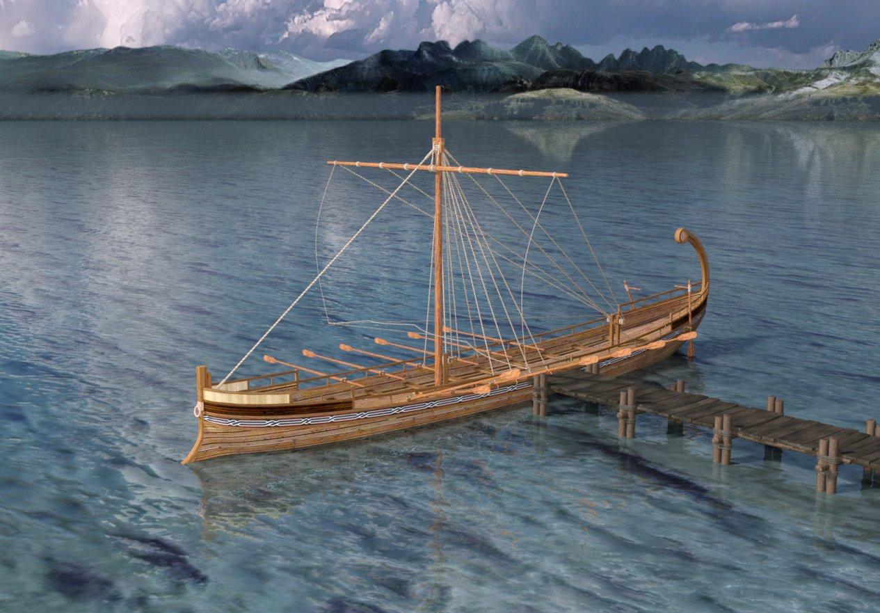

    Edit, here is the final effect on the Greek Boat. Note I did not spend much time getting the oars in the correct place, but they are all rigged as in the original boat, so you can but them wherever you want.

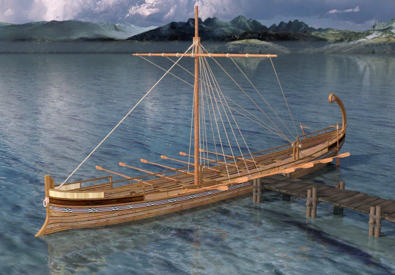

    Actually I spotted you also removed some of the ropes and rigging. Again this can be done with the geometry editor, here is my second attempt:
