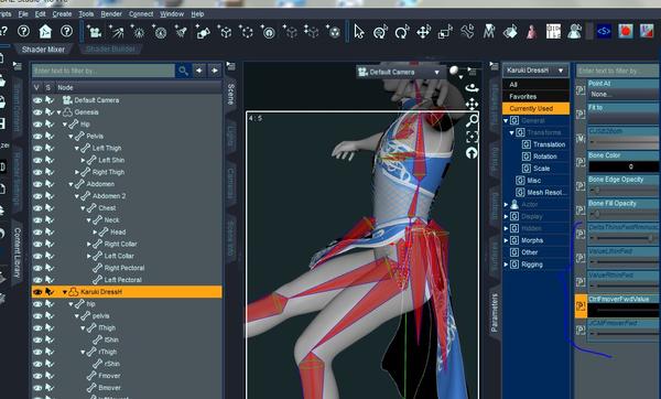

    Anyway my plan was,,
    1. transfer all rigs and weight map from genesis to my clothing obj.
    2. keep the original rigs (which need to fit to genesis rigs)
    in my pic, I keep both Thigh and Shins withut removing.
    3 remove weight from these bones (which you hope to not move by genesis rigs rotation)
    so that your clothing do not deform , when genesis Thighs rotate or Shin Rotate
    (Bones fit to genesis rigs, and move with , but they have no weight map,, so that clothing can not be deformed)
    4. add controll bones, in my pic I add 4 mover bone.but remain Thigh and Shin
    5 add weight map carefully to move parts by 4 mover bones
    6 Usually I recommend you stop work at this point. you poze clothing manually rotate these new movers
    7 But I understand,, you hope these rigs move when genesis bend their thin etc
    and make naturall shape,,
    try to set ERC when genesis Thigh rotate , set The thigh bones of clothing, as controller, then set some mover rotate
    as subcomponent .
    but not move when Thigh rotate back ,, (it is unnaturall)
    you need to set ERC for each movers. (it depend on, how you controll the clothing )
    Yes you can do it,, but you need many many ERC it work smooth.
    and carefully color weight for ghost bones.
    And you may find,, if you apply morph for genesis2,, the ghost rigs (movers) can not follow
    the shape.. you need to re-positon these ghost rigs,, without it your clothing break when pozing.
    (change pivot point to rotate) you may find ,,after you need many JCM to adjust ghost rig postion
    for each genesis morph,,,
    I think apply many ghost rigs is easy.. and may be you can keep clean weight map for ghost rigs (movers)
    But if I need to set ERC for Dress rigs,, and it move auto with genesis thin plevis, and Shin rigs,
    it is really crazy work.. (It can be done,, but take many time actually, and not fit for all situation)
    It is interesting,, but not so useful and recommended when someone make dress.
