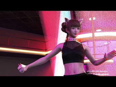

    If I were you, I would consider rendering an HDRI of your UF7 scene, and then only worry about your characters and objects they interact with directly.  You're going to have a hard time at 1080p otherwise.  Also, you might want to consider rendering at 720p and upscaling.
    In this runthrough clip, the club is a Daz set I made into an HDRI.  The volumetric spots and character are all that are in the scene.  This was rendered in 720p with a cutoff of 25 seconds a frame.
