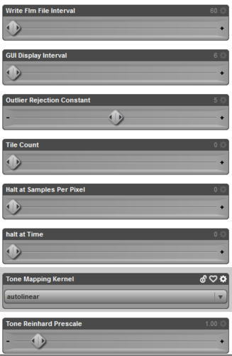

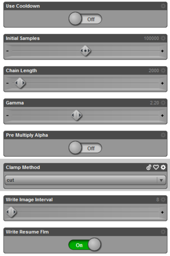

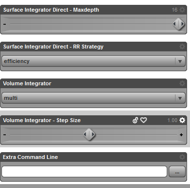

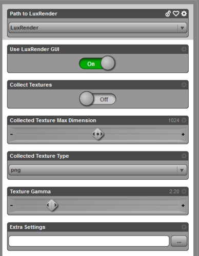

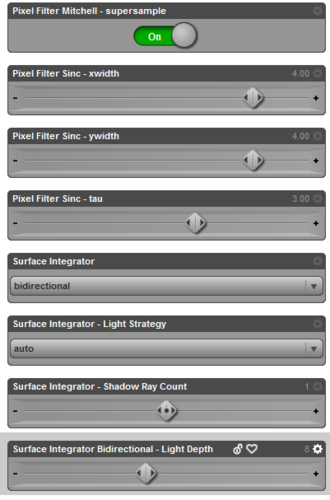

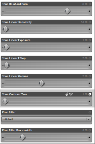

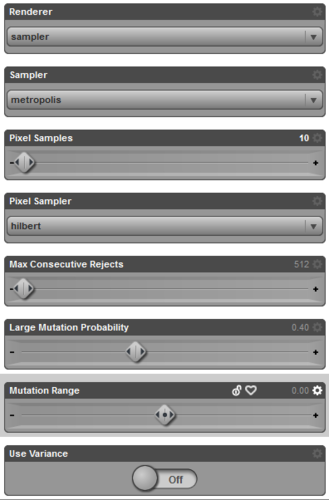

Hey guys I need some help I’m trying to use luxus render but the program is so blasted slow to render anything. An image that takes 3d delight 10 min takes luxus nearly two days or more. I’ve never used lux before so it is on the default settings and I’ll post the daz interface settings.
One thing I’ve tried to as lux suggested on their site was to install setup the lux blender but my menu does not look like what they are showing here http://www.luxrender.net/wiki/GPU_in_blender I did install the openCL version of luxRender.
http://www.luxrender.net/wiki/GPU#Pure_GPU_Rendering_.28development_versions.29
I tried the suggested tips and tricks. http://www.luxrender.net/wiki/New_User_Tips_and_Tricks
I do have luxus installed but i’m not sure how to pull up that menu and what are the limitations on lighting do I have to use theirs or can I use my own lights?

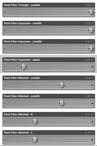

    Here is the rest of the settings.

    Luxus is only a plugin for DAZ Studio to facilitate sending DS scenes to be rendered in the Luxrender engine. Luxrender is an unbiased engine, and it NEVER stops rendering, until you tell it to. Most users go by the S/p (Samples per Pixel) display at the bottom of the Luxrender viewport, and when it reaches a certain amount (500 or 1,000 or maybe even 2,000) they stop the render. The render is finished when the user is happy with the finished result.
    Luxblend, as far as I know, is a plugin for Blender which uses the Luxrender engine as well.
    Post edited by JimmyC_2009 on
    Luxrender is altogether a different beast from 3Delight. As mentioned above, it never stops rendering and will literally continue forever if left to its own devices. Instead, you decide when enough is enough and end the render at a time you feel is right.
    Now, with that said there are a number of things which can contribute to longer render times. The most prevalent of which is simply not knowing how to set up a scene properly. Because Luxrender is a physically based render engine, you need to think in terms of real-world lighting and surfaces. That means lighting scenes for the camera, ensuring there isn't too much work for it to do (anything out of the shot can and should be removed).
    Since Lux calculates light realistically, unrealistic surfaces can also cause render times to take longer. Usually this means light bouncing around far too much or in extreme cases, surfaces which actually create MORE light without actually being a light source because they have physically impossible IOR or absorption. More light bouncing around means more calculations for your PC to perform, which means longer render times.
    There is a LOT to re-learn when it comes to using Lux or any other physically accurate engine, so I'd recommend taking a look at the links Jimmy kindly provided. You might get some useful pointers.
