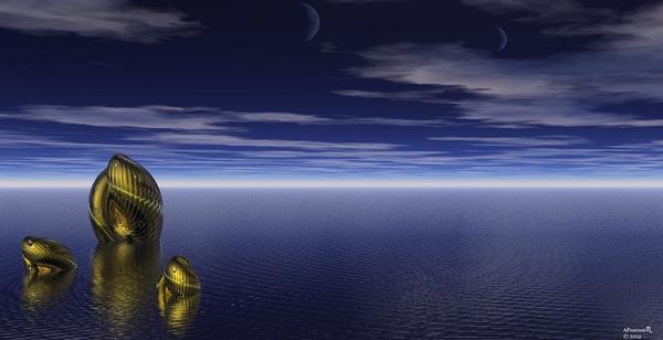

    Just thought I'd post this. Not entirely the result I was after but this is close. I still can't get a whole moon to work, possibly the sky & lighting combination are conflicting with my 2D images lol
    800 x 410 - 91K
  • Dave SavageDave Savage Posts: 2,433
    If you use an HDRI sky (in the IBL sky lab tab) you can exclude the 2D disc from the effect, then you can set up a light close to the disc and use the light lab editor to only include the Disc so that the (new) light doesn't spill light into your scene.
    It looks quite natural as you have it at the moment though. It certainly doesn't look wrong.

    Thanks for that, yeah I quite like the effect as it turned out but def want to do some full disk work in the future & it will bug the hell out of me if I don't figure it out so that may be the solution, though HDRI is a bit of a mystery to me at the mo, need to read up on the excellent tuts we have on this site :)
