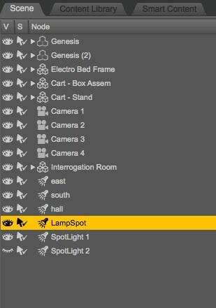

    Here's a look at the scene tab and parameter settings. There's a lamp above my main 'objects' :P .. shining down but none of the objects are casting shadows .. and turning on the deep shadow map just makes the lamp light dim.

    Okay that was weird .. I turned off Cast shadows on the rooms walls and floor and now I get my objects casting shadows. Kinda yippee ... but not really cos I don't understand why it's now working? How did turning off the cast shadows on the walls help? There are outside lights shining in but ... I kinda get it but I don't :P
  • Richard HaseltineRichard Haseltine Posts: 111,348
    What that probably means is that the lights were outside the room, so when you set them to cast shadows they couldn't get in at all (hence the light turning off). When you turned Cast Shadows off for the room the lights were able to reach the room. One useful trick is to select your light from the camera view list, at top right (where it will usually say Perspective View or the name of your camera) - with the light casting shadows you will then see what is going to block the light, which can be handy for making sure the light will go where you want.
