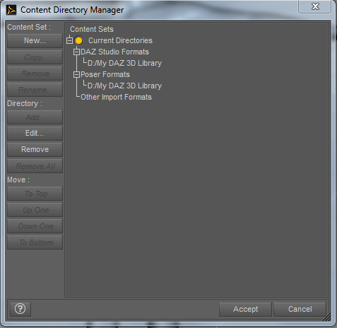

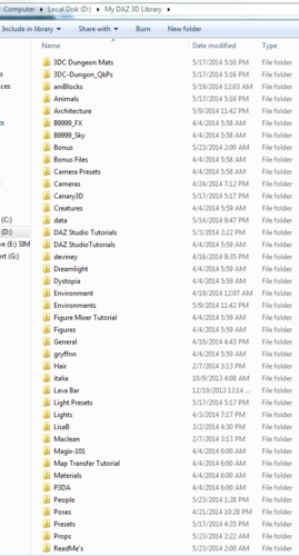

    I have ONE content folder and only ONE at this time. It is on my D drive, where it is does not matter a bit. If it is Set up properly does matter.
    First Image my Mapped folder. One is as much of it as I can show in one Snap last is my DIM set to use it.
    All my content works...

    As shown Folders Should be mapped as BOTH formats as content can be in either. Poser or DAZ Studio.
    Only Poser only folders as in a Runtime type folders gets mapped as Poser only. All DAZ Studio Content folders should be mapped as both formats...

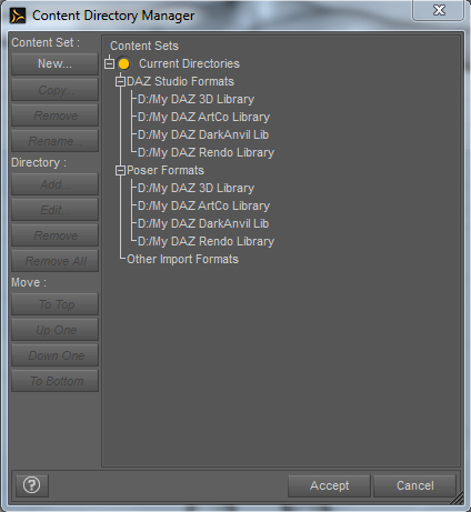

    It seems you have a "My Daz Library" for different product sets. Is that right? One for Artco. One for DarkAnvil. Etc? Is there a rational behind that?

    I do not have that set up any longer it was done to show proper folder mapping once in the past.
    I have been using DAZ Studio from DAZ Studio version 2, I have many old style content folders. I will set them up for doing some work that involves just the needed folder at that time. I still have many folders but only ONE full folder for DAZ Studio 4.5+ and all my new content. I use the other folders as work folders, I swap them in or out as needed, to test new things. That keeps me from messing up my one full folder if I make a bad boo boo.
