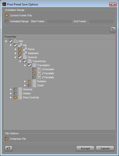

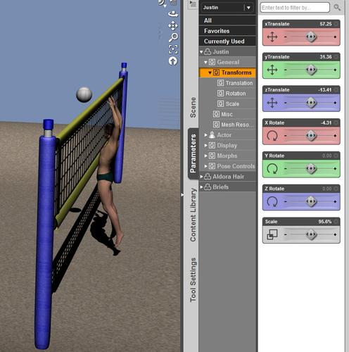

how to store own poses I now well. But the question is which parameters must be included and which better to exclude, so you can apply the pose to every random character (out of the same character family of cause) in every random scene for every random position/orientation of the target character.
In my example picture you see, that the character has got a specific hight above the reference ground and the pose needs a little x-rotation.
Given the case, the character is positioned directly on the ground (zero-level) for the new setup. If I apply the poses delivered in the Genesis basic bundle, the character gets all measures relatively to his starting position and orientation.
My problem is how to implement this behaviour for my own poses.
In the pose preset save dialog I can't find parameters to store translations and rotations relatively to the starting orientation/position of the target character. They ever result in absolute positioning. For the selection/manipulating tool I can switch between global and object coordinates. But not for the pose parameters.
Up to now I tried both: translation/rotation for the Character-Hip-General node or ony the Character-General one.
If using translations in the Character-General entries the target character finally moves to the same position of the creating scene independant of the new position of the target. Using the Character-Hip-General node didn't have any effect. The Genesis basic poses behave quite different (Example: leaping, running, sitting poses). So - how to do ??
Andy

    If your new character must have a different rotation orientation compared to the original one you created the pose with, it would turn into the direction of your creating character and not stay in the orientation necessary for the new scene. That was the point I despaired.
    But what I found out shortly after creating the question:
    In the scene tab and in the pose save parameters you see a node called "Hip". This node isn't selectable clicking on your character. It is only virtual and positioned somewhere inside the character between pelvis and abdomen. Think, it some kind of anchor. And it is the only character's node having x, y, z translation and rotation.
    And - if you perform the necessary translations and rotations for the pose with the Hip node, instead of the character, the saved pose works with every position/orientation of your new character in every random new scene.
    Andy
    Post edited by AndyS on

  • AndySAndyS Posts: 1,449
    No sorry,
    the pure translation and rotation definatly don't work the moment, your character has a different position, especially in y-translation. And the second case is a jumping pose. Here the character must have a higher y-value after posing compared to his position when inserted from the content.
    Your method allways generates an absolute positioning. That's where I despaired in trying. But I'm talking about relativ positioning for the posing. And this is only possible by hip translation / rotation.
    So you may try the following:
    Apply a pose to the character at the ground (at the origing in world coordinates). It should include a rotation of the body (x- and/or z-axis).
    Store it.
    Now apply the stored pose to the second character on the cube without any further moving of it.
    If you succeed, please show a screenshot of your pose saving dialog. I'm eager to learn.
