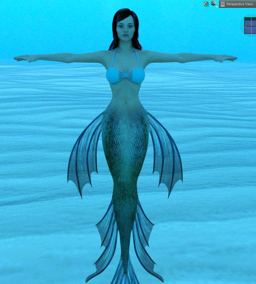

Hello all, a while back and I had purchased I had purchaced Sku #17331 Ultramarine Ocean:
https://www.daz3d.com/ultrumarine-ocean
I have not used it until now. When I load it up and do an Iray render, it comes out all black.  I quickly realized that this is due to the fact that the pack has a skydome.   While I do know a couple tricks with converting skydomes to Iray, this one has me stumped.  After converting the skydome to Iray, this is what I get:
So yeah, it doesn't look anything like the picture in which I want to create that shimmering wavy look of the water surface overhead.  I would like it to be less blue and clearer like in the photos for the product.   I am curious if someone who has this pack has figured out how to use it with Iray and I could use some assistance it getting it to work for my renders.
Thank you,
Geo

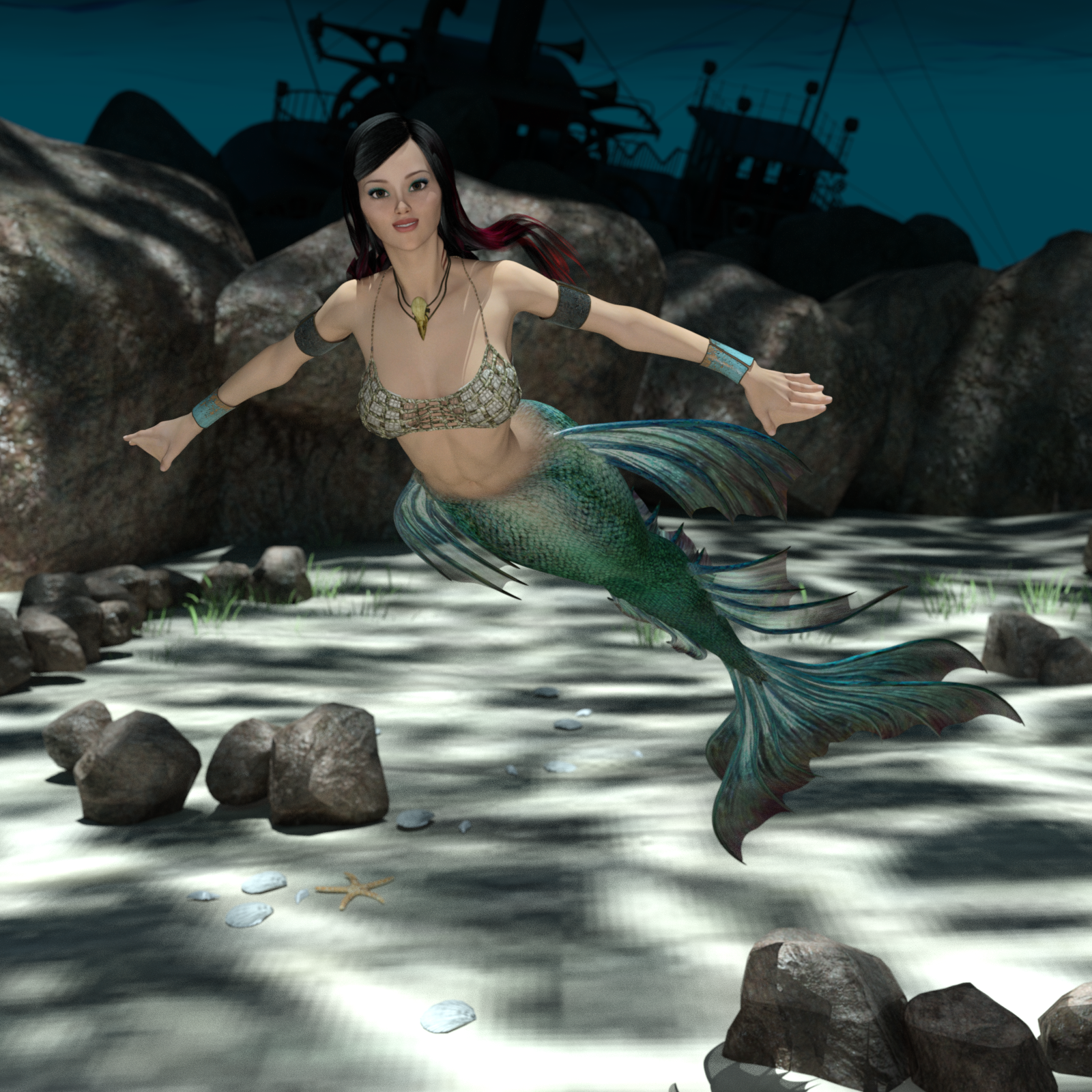

    Hello,
    Yes, I am aware of the skydome blocking the sunlight and I have learned how to make a dome emissive so you can see the results.  However, the spotlight for the sun doesn't seem to have any effect, even after I followed what you said above.  I have attached my scene tab with the items opened up in it:
    Now, a few things.  Obviously if I remove the skydome which is labled "Ocean Sphere", I will get the outside light to come in, but I still do not get the wavy pattern on the ocean floor.  At any rate, this look is not what I want because the dome has the blue water look and it is very much needed.
    Next, the "Water Undersurface" item, looks to be the water surface and I can turn this on and off too, but it doesn't seem to have an effect if I turn it off.
    Now it would seem that from what you mentioned above, all the action is happening under the "Wave Pattern Light" item.  Under this are two more items, the "Sunlight" item and the "Wave Pattern Gobo".  The sunlight item was what you are referring to and I made the settings as per your instructions.  Nothing happens.  In fact if I click on the visible icon on the left in mid Iray render, it has no effect at all.   However, in the "Textured Shaded" preview, it does have an effect and turning it off yeilds the same blue looking view in the viewport like the rendered scene I have above.
    Generally when you make ANY change during a render, Daz will automatically stop the render and start it over again, but adjusting anything under "Wave Pattern Light" doesn't do this.
    I have tried some tricks like lowering the "Water Undersurface" item and putting a VERY large primative ghost light above it and cranking that up, however, the "Water Undersurface" layer is blocking it.  So it would seem that this is for just an effect when viewed from below.   I tried to mess around with the settings for the "Wave Pattern Gobo", but it seems like it is an invisible item...even with it set to visible in the scene tab.
    I hope that explains better what is going on my end.   Any suggestions on what to do next?

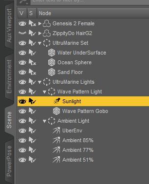

    I suspect that the Sunlight spot is outside your Ocean Sphere. In the scene tab, make sure nothing is selected, and using the Perspective view (so as to not mess up your cameras) click on the Frame controls (the one with the framed crosshairs) to see where the spotlight is relative to the dome. Attached is the original layout showing the relative position of the sun and gobo w.r.t. the ocean dome. In 3DL, you can make a surface not cast shadows, so it isn't a problem.
    To use it with Iray, making the dome emissive will give the blue ambience, but will still block any lights outside unless you make it transparent, which would defeat the purpose of having it in the first place, unless you want to start messing with volumetrics. You need to ensure that the Sunlight spot is inside the dome either by making the dome bigger (> 125% for this specific set, if you change nothing else) or moving the spot and gobo inside. If you are using your new dome image as the Environment image, it won't block the light, since the environment dome works differently from physical domes in Iray. That's why (well, at least one reason) HDRI's are so easy to work with.
    The Water Undersurface is used to have an actual surface, since there is no volume being used for the water. It just dims the light from the sunlight and gobo a bit.
    BTW, there is a native Iray product that will do basically the same: Aguja Undersea Environment. (Marshian is involved with both products, so I don't think he would mind)
    Yes, this is correct, the lights and the gobo were OUTSIDE the dome.  I am wondering why this was the case taking into account that unless the dome is transparent to 3DL, no light is going to get through the dome.  At least it doesn't in Iray.

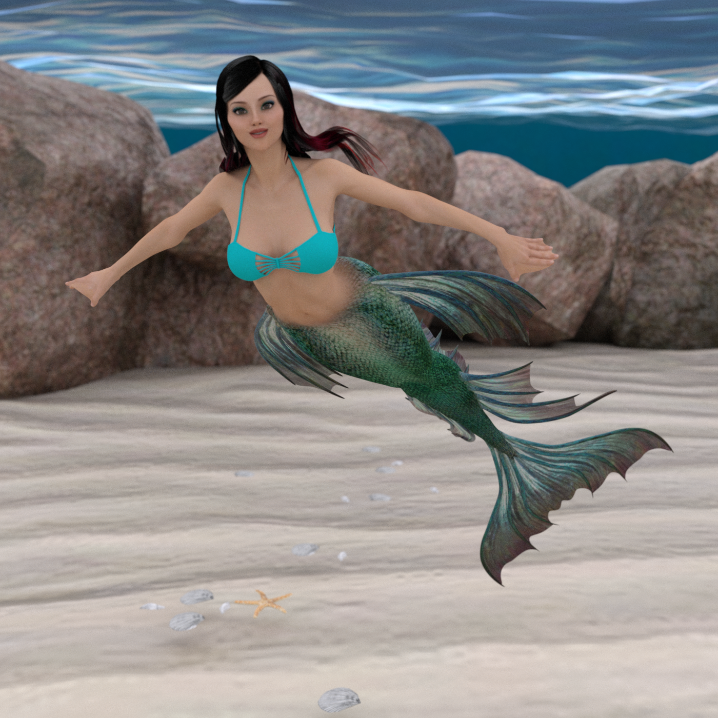

    You almost have it. In 3DL, you can set all sort of properties that are not "real" in order to achieve an effect. The dome in the original is set to not cast shadows, allowing the use of a spotlight shining in from outside, like for the sunlight and the wave pattern. Iray uses the actual transparency/translucency/refraction, etc., of any and all surfaces that a light ray will encounter on its journey. It will see the dome as non-transparent and block any light, in effect reflecting it all back on the outside.
    Okay, here's what I did:
    Ocean Sphere: Scale 125% (just enough to enclose the Sunlight spotlight). Convert to DAZ Uber Iray shader (Ctrl-double-click, Surfaces -> Selected, Images-> Ignore. Yay! Now it puts ambient in the Emissive channel). Set emissive to 500 Kcd/m^2 just to get the blue ambience (should have the blue gradient map).
    Wave Pattern Gobo: Tiling to 2x2 to make a tighter pattern. You can play with the height of the pattern or spread angle of the spotlight to get different results.
    Sunlight spotlight: Photometrics ON. Lumens 300,000,000 or more. You can hide or delete the UberEnvironemnt, it does nothing in Iray. The other ambient lights are distant lights outside the dome, so, what did we learn about lights outside the dome? Off or delete. You can add some spots or ghost lights near the figure to get better illumination.
    The lighting could be improved (too blue), but you get the idea. The promo looks like everything has been brought closer together (sand bottom, water undersurface, wave pattern gobo), so your results may vary.
    800 x 800 - 208K

  • NorthOf45NorthOf45 Posts: 5,896
    Understand that the original was 3DL, and that shader engine has the parameter to not cast shadows, it is not a property of the dome itself. It does not translate to any Iray setting, so you have to do something else. The "dome" in Iray is an environment dome and is handled differently. It is usually a HDRI light source, and can be used as a background image if it has the high resolution image included. Lighting data is quite low-resolution.
    Didn't move the wave pattern, didn't move the sunlight spot. The wave pattern gobo should not be an emissive surface, it will just blanket the area with non-directional light. I did not convert any other surfaces to Iray Uber shader, the Iray renderer can handle most simple surfaces as is, but you can convert them to speed up load times. If you converted the gobo to Iray, make sure the Cutout Opacity has the original's opacity map. Test the sunlight/wave pattern by themelves by turning off the other stuff (except the sand bottom) to see if you get something. You are certain the spotlight is inside the dome?
    I tried another way that doesn't need any domes or HDRI's. Hide the Ocean Sphere. Set the Environment mode to Dome and Scene, set the Environment Map to None. This will force Sun-Sky mode with working scene lights. Set the Blue-Red Tint towards Blue (duh), and drop the horizon a bit so that it does not show above the edge of the sand. Add a little SS Haze and you should have a pretty close representation of an infinite ocean. If you add a Sundial Control (under Render Presets->Iray in the Content Library) you can control the direction and intensity of the light in the scene and still have the wave pattern from the overhead spotlight.

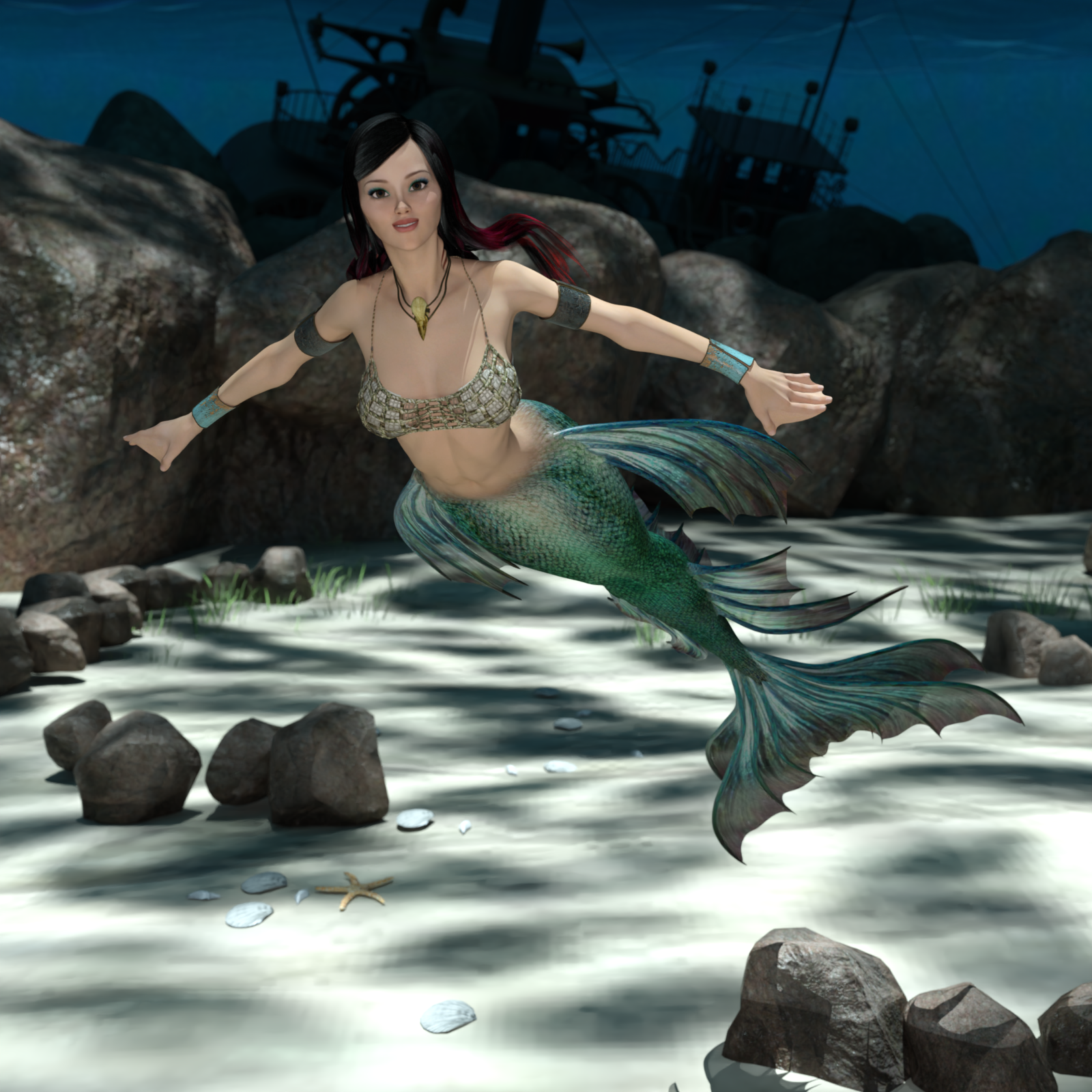

    Ok, I started completely over and did it the way you did.  Instead of moving the distant light and the gobo, I increased the dome to 125% and made sure the distant light and gobo were inside.  I setup the dome to Iray as I know how to do this already.  I then set the gobo to a 2x2 tile, and turnd on the parametic parameter for the distant light and set it to 300,000,000.  Expectedly,  I still didn't get it to work...at first.  BUT for some reason it clicked in that as a creature of habit to set the Environment setting Sun-Sky for the dome.  Thus that is why the distant light wasn't working.  So I set the environment to Dome and Scene and the light started to work.  I ended up buming it to 400mil as it wasn't bright enough, but now I was getting the effect you had above.
    I followed this as well and managed to duplicate what you did above without using the skydome and while it works, the dome color was too blue.  Sadly there is only one tint slider for red and blue...there is no adjustment for yellow and as such I couldn't add yellow to the blue to give it a greenish tinge.   So I went back to using the emissive skydome method and I adjusted the color and intensity and this was the result:
    WOW!  So that was 100 times better!  Naturally I have added more to the scene to make it more interesting, but this is certainly FAR closer to what I wanted to achieve with the Ultramarine Ocean package.  In fact seeing these results certainly means I do NOT have to buy that Iray package.   However, there are a couple of things keeping this from being nearly ideal.    The main one is an issue in the foreground.  Can you see those lines in the sand?  I want to get rid of those.
    Next, I had recalled in playing with the lighting settings on the dome emission that lowering the lumens actually makes the ocean darker, which is what I was after.  So this had me thinking that if I tried the Environement dome settings again and altered the Environment Intensity, I might be able to achieve a similar result without having the need to make the dome greener looking.    I have that render cooking right now and will post that later on.
    Finally, this render took a VERY long time.  Over 2 hours and more than 8000 iterations.  Since that was my set limit, the render ended itself before it fully finished.   So whatever I was doing here certainly ate up my GPU power big time!   I do admit adding the boat to the scene might have been the culprit.  It is a big boat and If there was a way to lower the resolution on that perhaps it will render faster.   But I think there is more to it than that.   As it is, I had to turn on the headlight on the camera as the front of the mermaid was too dark as all of the light is coming from above.
    For the Environmental Settings Dome, I tried to find the sundial controls in hopes of changing the 'sun' around, but couldn't find them.  However, there is a "Dome Rotation" control even under Dome & Scenes, so I will play with that and see what I can come up.
    Edit:  I did a quick peek of my render with the Ocean Sphere skydome off and using the Enviromental Settings Skydome.  It looks like the idea of reducing the Environment Intensity is working.  I had set it to 0.1 and that made the dome dark enough to give me that dark bluish-green look exactly like the image above.   So I decided to stop the render and see if I could rotate the dome so the light was more on the mermaid.   Well, that didn't work out so well as the dome is set for too low of an intensity to cast enough light on the mermaid.   If I increased the intensity of the skydome than the rotation will work, BUT now the light is mostly blue.  So I put it the intensity back down to .1 and put the camera light back on.
    While the render is cooking now, the background color looks good.  So it looks like I may not have to use the Ocean Sphere dome even though I think the overall look is a bit better using it.  So all I really have to do is address those lines on the sand and I think I should be good!
    Edit:
    Ok, about 1:45 hours later and 8000 iterations later, I have added the second render.  Now this one is with the Ocean Sphere skydome turned off and I am using the Enviroment Dome within Daz Studio.  I have set the Environment Intensity to .1 to lower the light level to get the color I was looking for:
    Other changes I made here is that I convered the sand layer to SubD in the hopes those lines would go away, but they didn't.  So I don't know what is going on here and hopefully someone could help me out with fixing that issue.
    In comparing the two renders, it seems that the version with the skydome looks a bit more detailed in the distance.  Naturally because that is an actual image, where as the image was removed from the Environment Dome for the second render.  Still it is overall negligable.  I would say that even the render time didn't improve much.  Still it was finished in 1:45 instead of 2 hours.   So it was a smidge faster.   All in all both renders are using three light sources; the skydome (either what came with the package or the Environment one), the distant gobo light, and the headlight on the camera.  I guess with being a plain flat surface and not an image, using the built in Environment skydome ended up being a bit faster.
    Looks like I am getting there as there is NO question now that my mermaid is under water!  I just need to fix the lines on the sand, add some bubbles and I am set!

    I guess I would still have to play around with the gobo height and make it lower yet?   One thing I didn't try was to remove the Ocean Surface.  I was curious if that might have something to do with it.
    NorthOf45 said:
    Post Denoiser Denoise Alpha: not a lot of info about it, but here is what was described when it was added: Daz Studio Pro 4.11 - Highlights, and a brief discussion about it: Post Denoiser Denoise Alpha...Come Again?.
    Hmmmm, for the most part it doesn't seem like it is something critical.
    So I am going to try to play with the gobo height some more and also remove the Ocean Surface to see what happens with the sand.
    Thanks,
    Geo
    1600 x 1600 - 3M
    Post edited by Chohole on
    edited June 2020
    I think a better approach to getting rid of the pixelation of the wave pattern is to remove it at the source. Any decent graphics program can resize and resample to get rid of any aliasing in the image for the gobo. The original is 1K x 1K, which is kind of lo-res for the task. I have made it 2K x 2K with some sort of resamplng algorithm (Paint.net's "Best Quality") and replaced it in the Wave Pattern plane. Since it stretches to fit the plane, no need to re-tile the texture, it is just higher resolution.
    I made a couple of renders to show the difference it makes. Both are identical (about 1000 iterations, no filtering), the only difference is the wave pattern image resolution. You can clearly see the banding/pixelation/striping at 1K, not at all at 2K, even if it is grainy. It might start to show a bit after more iterations, but then you can lower the de-noising (or rather, raise the starting iteration), or make the bitmap even higher resolution, like 4K. It's only one image, and will have the most impact on the quality. A worthy expense, I think.
    1600 x 1600 - 2M
    1600 x 1600 - 2M
    Post edited by NorthOf45 on
