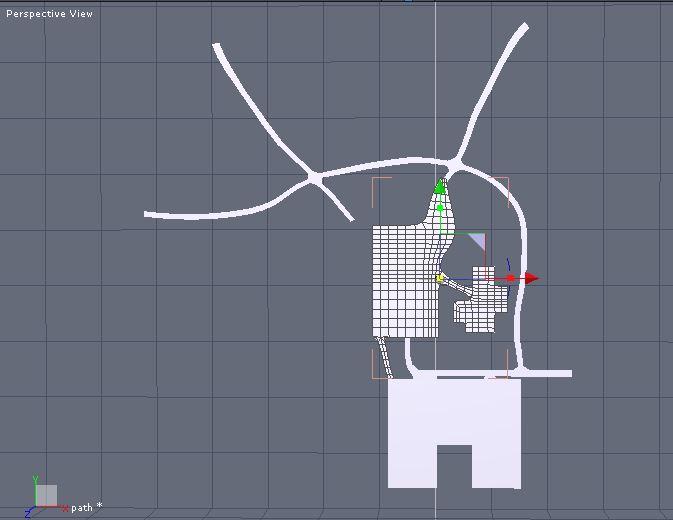

  • RakudaRakuda Posts: 938
    edited June 2020
    Well, short of a technique for loading up a backgrouound, I am just visually estimating.
    673 x 520 - 43K
    Post edited by Rakuda on
