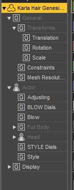

  • SevrinSevrin Posts: 6,314
    edited June 2020
    It's a really nice hair, with lots of options.  Once installed properly, there's all this under Actor.
    149 x 383 - 17K

  • LBSTHLLBSTHL Posts: 20
    Thank you all for your replies!
    Chris, Sevrin: Sadly, it's not under SHAPING either. In fact, none of the sub menus from Sevrin's screenshots is there, making me certain that something's off with the installation.
