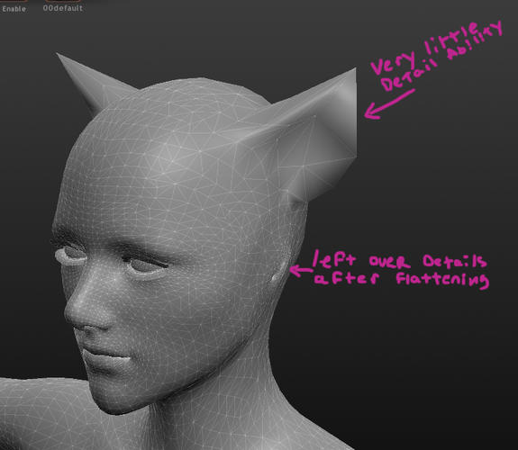

    My first Morph yay! I just tweaked a few features on Genesis 2, nothing to big, then I flattened her ears and added cat ears. They didnt look half bad considering the tiny amount of details allowed on the scull.
    I guess its not possible to change the wireframe triangles (what are the called?) to ad any more details =(

    Nope you can not ADD more facets (points) that breaks the mesh count which must match. So your limited to pretty much doing as you have so far.
