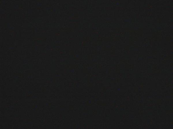

Can anybody identify something of what this image is covering.
Thank you in advance very much.
Click on image to get larger one.

  • StratDragonStratDragon Posts: 3,290
    can you provide a little more info? What steps did you do to get that image and what did you expect to see?
  • BeeMKayBeeMKay Posts: 7,019
    It might be the Big Dipper, with the polar star in the center of the image.
    edited May 2014
    might be the belt of Orion in the center, which hemisphere was this taken? Where were you and what time was it and what direction were you pointing the camera?

  • rubidiumrubidium Posts: 29
    I'm afraid that I can't see anything... I am disoriented by the red and blue dots... Is it a photograph that you have taken? Perhaps the exposure is too short and trying to boost the contrast boosts the electronic noise?
    Ramon
  • nightwolf1982nightwolf1982 Posts: 1,321
    Might be the constellation Draco

  • icprncssicprncss Posts: 3,694
    Do you know what direction you were facing when you took the photo?
    Not wanting to sound dumb here but are you in the Northern Hemisphere or the Southern?
    In the North, it's always a good idea to locate the North Star and Little Dipper or Ursa Minor. In the South, I believe the reference is the Southern Cross. I have no experience in the the Southern Hemisphere doing limited equipment night land navigation maneuvers.
    On my monitor, your attachment just looks black so I don't see anything. Sorry.

    Hi, I'm back from today's shopping trip.
    Okay ... what was I expecting to see ... uh, hmmm ... well, you know .... had a bit of insomnia so got up "very" early in the a.m. and thought I would try out my new telescopic camera. [putting it in instead of an eyepiece to a deep space telescope]. What we had in the night sky AFAIK, was a silver of a moon and a whole bunch of clouds. I was expecting to see the moon. [I had done a few test shots during the daytime to be sure I understood how to work the camera's software ... everything appeared to be working fine. Could see ants climbing limbs.]
    So my first thought was it was jumping way past the moon into deep space. I live in Ottawa facing southward. BUT please do not let my location be paramount to identifying "what part of the sky" this is because I have good reason to suspect that, well ... "could have been from anywhere". I actually made another little home video to prove something because what was happening was "unbelievable" IMHO.
    I tried matching it up with Orion's belt but all the stars don't match up quite right for that.
    I will check out the other suggestions and see if I can make a match.
    This is "my" image so yes, people can download it and send it wherever ... i would really like to know what the camera was taking pictures of.
    Thank you.
    Here's the same image run through another program to enhance and crop some ... all those dots of colour are supposed to be 'stars' or 'planets' as far as I know. The stars were twinkling -- got a few .avi files of it too.

  • Scott LivingstonScott Livingston Posts: 4,352
    Did you see (through the telescope) the red and blue dots, or did they only show up in the photo?
    The camera's software offers an option to colour enhance things ... or have everything black 'n white. If you want to change it to black/white/negative/whatever, go ahead.
    edited May 2014
    I guess what I'm wondering is, are the red and blue things actually there, or are they just noise or image artifacts of some sort...
    Edit: if one interprets them as stars, then I think I agree with Nightwolf1982 that this could be Draco and the Little Dipper (compare to this image, specifically the top half of it): http://upload.wikimedia.org/wikipedia/commons/c/c3/DracoCC.jpg
    Hard to say, though!

    AFAIK they are not artifacts in that they certainly didn't appear in the first test images it made.
    The overall effect in the images look to me like some I've seen off of very expensive telescopes which really see tons of stars 'n stuff.
    That's not quite what I own though. If I disconnected the camera from the computer, the images went "poof" and the message that no camera was found comes on.
    So the images were coming via the camera for sure.
    The computer was 'offline'.
    I think this is a very interesting camera. But ? what it is taking pictures of?

    That looks pretty close ... I shall try overlapping that to check. Thanks :-)

    What you are seeing is digital camera noise (hot pixels, I think they might be called) from a long exposure. There are no stars in this picture, because your exposure time was not long enough for them to show up. Leave the shutter open a lot longer on your next attempt (maybe try adding another 30 minutes or an hour and see what happens, then go from there). Unfortunately, those colored dots are going to get a lot worse when you do that. You will have to photoshop them out. Unlike film cameras, some digital cameras (like yours and mine) are very bad at this. I believe there are some cameras designed to reduce this effect though.
    If you wish to prove this to yourself, take the same photo with the lens cap on, and you should still see the dots. (Incidentally... did you remember to take the lens cap off? :-)
    Obviously, if you are going to do a long exposure you'll need a tracking device or your stars will leave trails.
    The photoshop workaround requires taking your picture, then a second picture with the lends cap on right after the first. Because this exposure was taken (with the lens cap on) immediately after the main exposure, and using the same exposure settings, the ambient temperature of the CCD sensor should be about the same and the hot pixels (dark current noise) should be more-or-less the same as in the previous image.
    In Gimp (I don't have photoshop, so I used Gimp), open the real photo in one window. Open the lens-cap-on photo in a second window and copy it to the Windows clipboard. In the real photo, from the menu bar select Edit > Paste As > New Layer. In the "Layers - Brushes" tool window, change the Mode dropdown to Difference and verify that the Opacity (field right below it) is at 100%. Layer > Merge Down.
    This isn't a perfect fix, it still looks nasty close-up, but it's better than it was.
    Here is an example of a shot taken inside with my camera in the dark:

    Yup ... apparently so. Got a hold of the nice man that sold me the camera and sent him the picture. He says it's "hot pixels" and "noise" ... and for some unknown reason it's purely coincidental that it happens to resemble any constellation(s) at all.
    Thank you for the workaround ideas ... looks like I'm going to needing such. I have Corel's PSP programs to work with.
    The camera was sending "dots" to the computer ... anytime. Telescope open/capped/pointed "anywhere" ... I had the moon in the sites but it wouldn't show on the camera. Was told that the camera's lens thing is very small. This is going to "fun". Have all next week to set aside to "try again".
    Update for anybody that's interested.
    Turns out that why the camera was "live", it wasn't always sending pictures to the system. After a program update and a computer reboot, issue seems to be resolved except ... minor detail here ... apparently it's not supposed to take pictures of stars, just stuff like the moon.
    One day I will learn, I have a deep space telescope, rather overkill for the moon ... in telling the salespeople this, I assumed that the camera would also be such. Oh well ... if one night the clouds clear and the moon is visible "maybe" I'll get some photos of that with it.
    Also I've noted that yes, for camera "noise", these cameras have a LOT of little round green, blue, red, etc "dots".
    So in case I forget to clarify with my DA photo uploads, the cameras that take the images uploaded to date do not normally have tons of little coloured dots to confuse people. The "red rock" and "star/planet" whatever are not camera noise. After posting [naturally] I discovered some other photos released in the news ... so I'm thinking that possibly my red rock "might be" a brown dwarf because apparently yes they can be red. [people like me would call those then red dwarfs but hay!]

  • LeatherGryphonLeatherGryphon Posts: 12,481
    Yep, those red & blue dots are probably noise. I first ran into it when taking photos of Shuttle launches at night with shutter held open waiting for the rocket to fly through leaving a trail. I first thought "cool, I got stars too" but later determined that they were noise by taking a photo with the lens cap on.
    For what it's worth, you can try sitting about 100 miles above the earth and cool your camera with liquid nitrogen. I hear that works really well! 8-o

    was gonna say, just hot pixels and noise.
