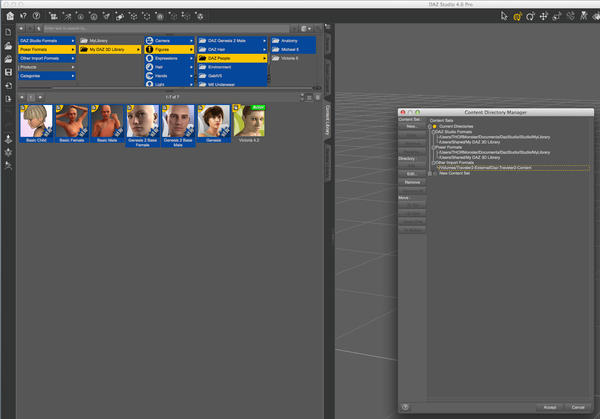

    1. This is the same machine, I had a previous version of Daz installed not used again like I said before but it was there. It seemed to function at least I could see the content that was installed…
    2. " DS won’t have added the \My DAZ 3d Library folder in Public Documents as a content directory; " I attached a grab, Think it did put one there unless I am misunderstanding…
    3. " should have removed entries for the content from the Content Management Service " If so then the errors make sense how can I completely wipe it clean? Or is there another way?
    4." you need to go to Edit>Preferences>Startup, and possibly Edit>Preferences>Scene, to change or remove the file that is automatically loaded." I think on the mac you get this from the under Daz studio/ preference but anyway I have included a pic of that as well. It seems to not be loading any image currently…
    5. " Is Users/Shared/My DAZ 3d Library added as a content directory in DAZ Studio? Edit>Preferences>Content Library, click the Content Directory Manager. " I don't even see where to click the CDM?

  • TotteTotte Posts: 15,288
    Check the image in the first post in the Mac FAQ thread here for information on setting up paths for DS/DIM.

    @Richard, Totte... notice the full UI and Preferences screenshots... dgood133 is using the Full Service [Beta] layout... won't have access to Content Directory Manager unless the layout is changed to something other than Full Service [Beta]; has no button in Preferences dialog, and no pane option menus when the Workflow Assistant is active... which it is in Full Service [Beta].

    So, go to the menu Window->Workspace->Select Layout and select another layout, for example City Limits.

  • Richard HaseltineRichard Haseltine Posts: 112,049
    Also, in the Content Directory Manager (second screenshot) please click the + symbols next to DAZ Studio Formats and Poser Formats to show the actual folder names - you should see, at least, /Users/Shared/My DAZ 3D Library there.

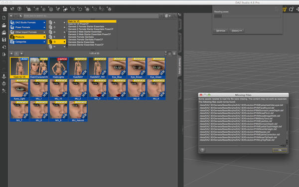

    most of the actors will load but they come in in what looks like wireframe clothing as well
    also still getting a message about missing files I have attached what I mean,
    edited May 2014
    (a) Do you have the Genesis Evolution Morphs installed?
    (b) What is your display options set to?

  • frank0314frank0314 Posts: 15,116
    It looks like your missing the Evolutions morphs. http://www.daz3d.com/genesis-evolution-morph-bundle
  • JaderailJaderail Posts: 0
    edited May 2014
    Is your DIM content Path actually pointing to Users/Shared? It looks to me as if some of the content is not mapped.
    EDIT: Or you just do not have the Morphs installed. Can be that too....
    Open DIM, go to the Installed tab and scroll down to Genesis and see if you have Evolutions installed. If not then you need to purchase it for it to work
  • david_f128548309david_f128548309 Posts: 0
    thank you sir that what it was…
