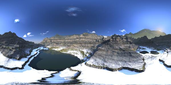

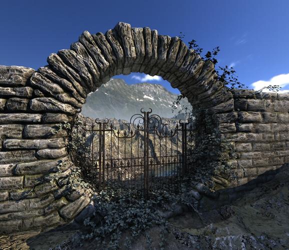

  • David BrinnenDavid Brinnen Posts: 3,136
    edited May 2014
    @ David i tried the way you said, it blanks out the option to render to disk when rendering if i click on the render it stops rendering completely hmmm! not working the way you said, will try seans way and see if this helps., i not used the instance lab so will give it a go and see, thank you all for the help, have a lovely weekend
    Yeah, probably my fault for not explaining it very well, I will try and make a video at some point about render to disc as it is occasionally a source of confusion.
    Edit here you go Bryce Basics - interrupted rendering - by David Brinnen
    Edit edit and... Bryce Basics - render to disc - by David Brinnen
    1700 x 850 - 515K
    982 x 850 - 455K
