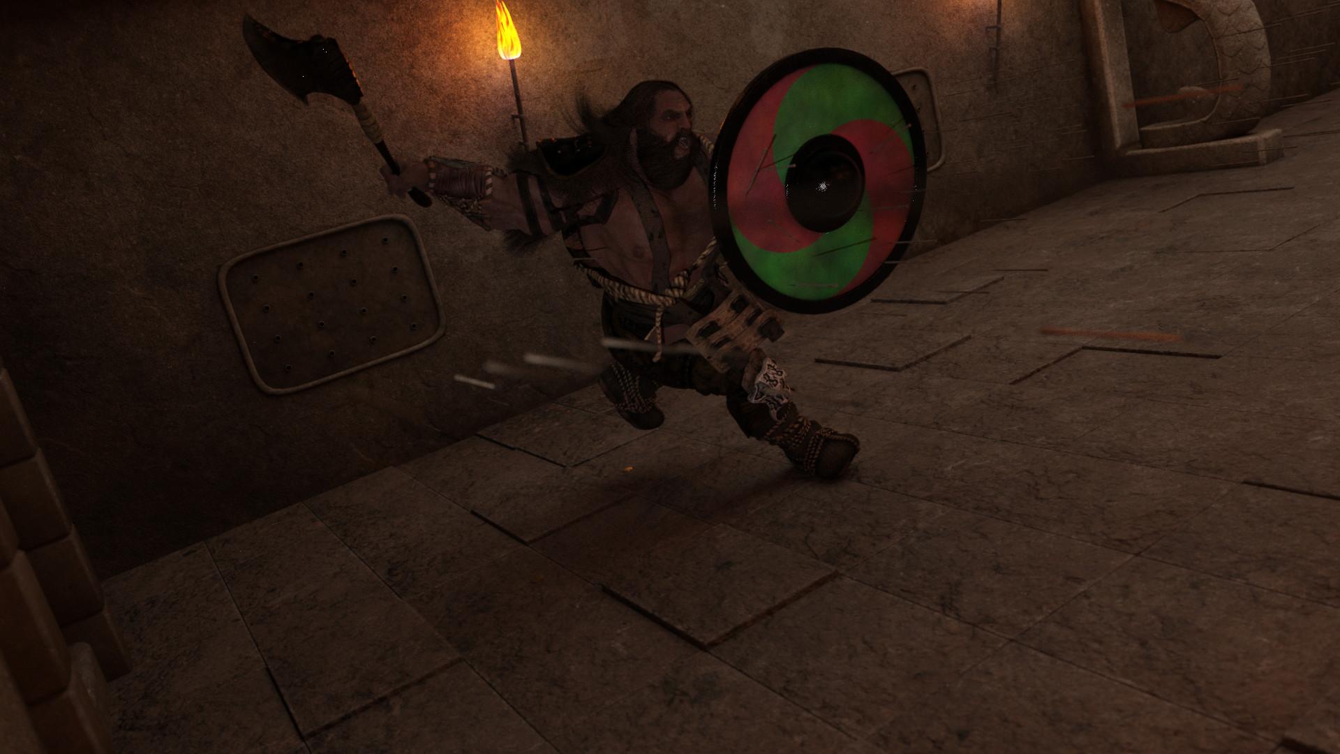

The treasure of a lifetime lies in the vault, ready for the taking. All our heroes need to do is cross the hall and open the stone doors. But that's easier said than done when the traps could spring at any time to catch unwary thieves...
Fantasy Trapped Vault is a complete interior environment with poisoned-dart traps, spiked pit trap, and door lock blade-traps. And treasure for the vault, of course.

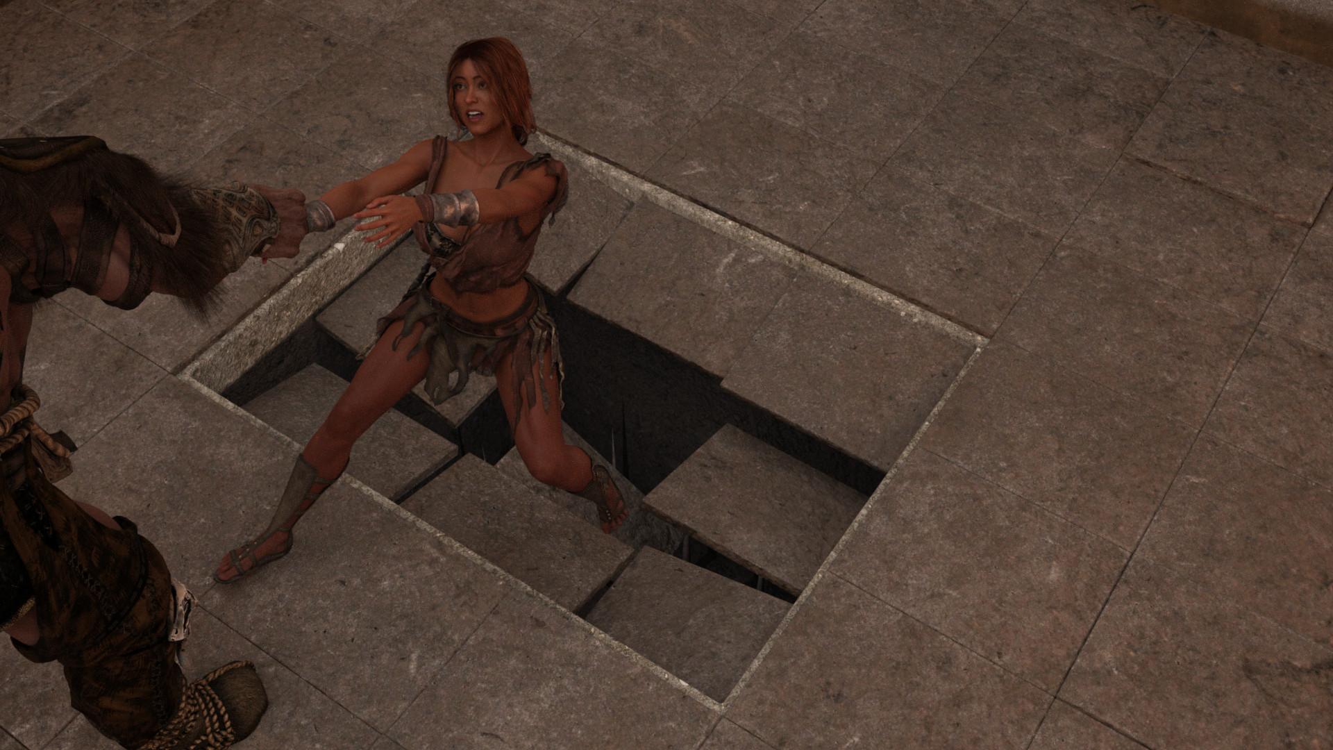

The floor has 3 pressure plates that depress. The darts are grouped and offset to avoid looking unnaturally regular as they shoot out (just grab a group and slide the 'shoot' parameter). Dart also has 2 uv sets for subtle differences when side by side. There are 9 floor tiles as individual props above the spike trap for customizable drops - set also comes with a pose preset to drop the tiles (and another to reset them).

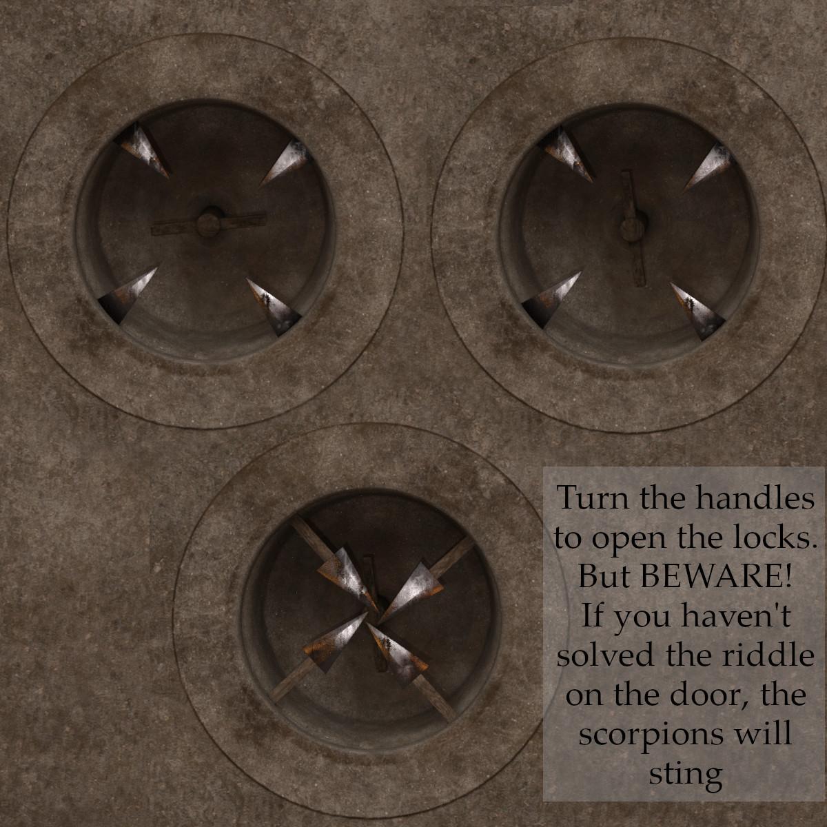

On the vault doors is written a riddle in ancient Cunieform script (but English language since I don't speak ancient Sumerian :p) "The Moon Rises East, The Sun Sets West, The River Flows South, Scorpion Stings" - your characters must solve it to kndw the correct order to open the door locks or else the blades will spike their arm ;)
The vault doors slide open. The treasure comes with gold, silver, and bronze options, and 5 colour options for the gem (or use the surfaces tab to make them any other colour).
The chest has 3 hierarchical pose files for the lid 'on', 'leaning' or on the 'floor'. The torch is included and comes with morphs for the flame and handheld 'wearable presets' for Genesis 8 male and female. The flame morphs are designed to be used in combination.
4 light planes and an optional 'tone mapping' preset completes the lighting. Depending on the camera, deleting some of these lights/torches will make for more dynamic lighting.
The set also comes with 7 cameras to get you started with rendering.
Do you dare challenge the traps of Fantasy Trapped Vault to gain the treasure for yourself?
^Click pics for much bigger versions :)

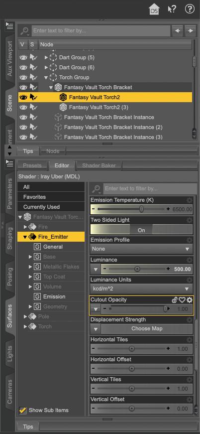

    After applying various shaders, modifying various settings, and looking at the torches, I finally got it and saw what I missed initially: the transparency was set with a cutout opacity map (I saw it because the Fire and Fire_Emiter surface of the torches didn’t have the same cutout map, before, I didn’t see the presence of a cutout opacity map at all blush) enlightened:
    For people who are as new to this as me, I removed these cutout opacity map by clicking on the map then ‘none’:
    Which ‘fixed’ the light panels, or more precisely, at least, they started emitting light while being invisible themselves smiley

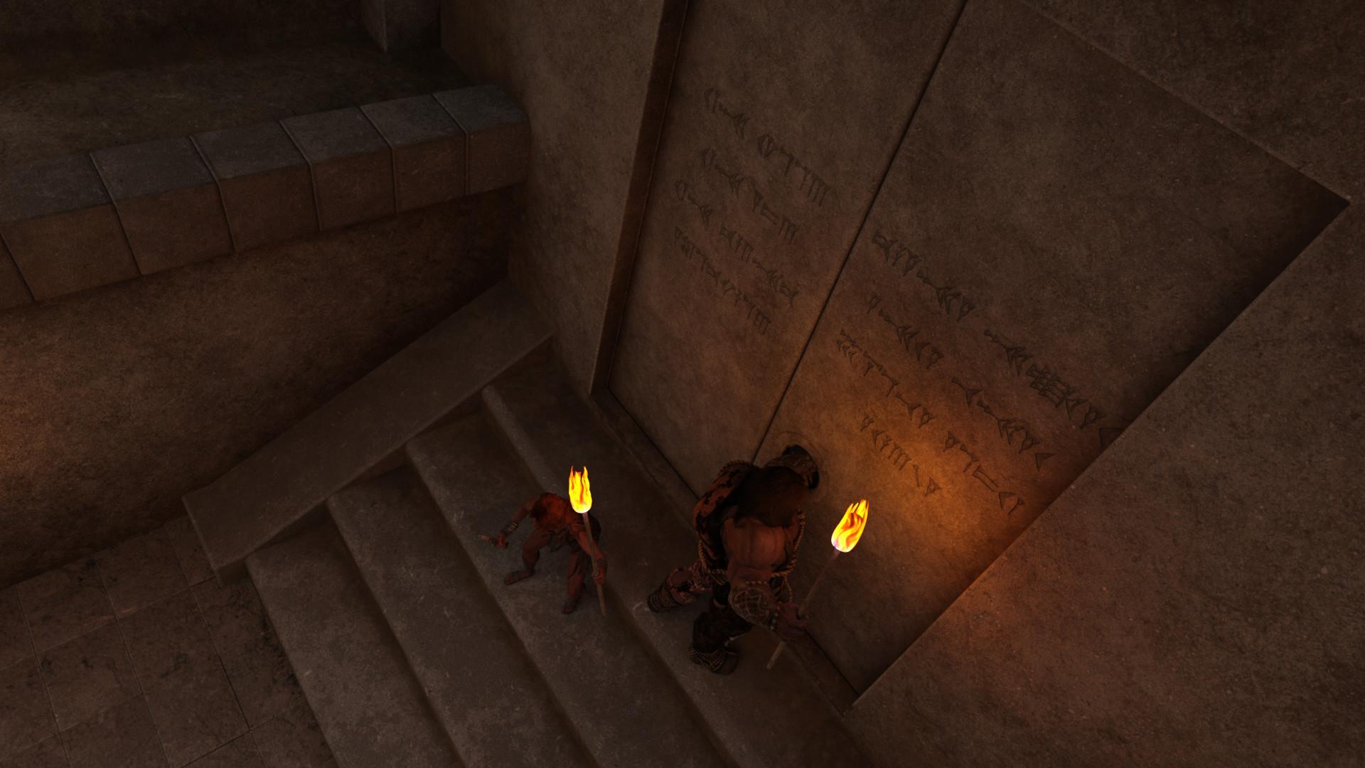

    Fixing the torches required a bit more actions, because simply doing what I did with the light panels isn’t enough: as the ‘ghost lights’ of each torch is set as a surface (Fire_Emitter), removing the cutout opacity map and setting ‘Iray Visible to Primary Rays’ Off made the whole torch invisible (at least the one that isn’t an instance), which is not what’s wanted crying
    So, I duplicated the torch, and only removed the cutout opacity map and set ‘Iray Visible to Primary Rays’ Off on one of them, keeping the rest as created by @Silent Winter and it seems to me that the fix was propagated to every instance (as it should, but I’m not very experienced with using instances with Daz Studio). That’s how it should look (here, I made the change on the original torch, not the copy, but it should work fine either way):

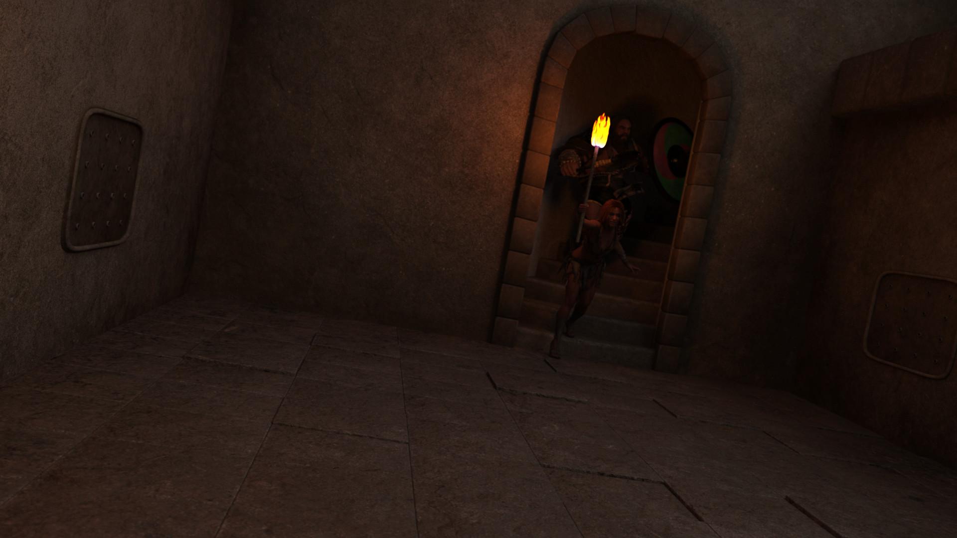

    They are two limitations of this solution. First, light panels cast a shadow and I have no idea if it’s possible to fix that, but as long as you’re not looking directly at one of them, it shouldn’t be a problem. If you are, well, it looks like that:

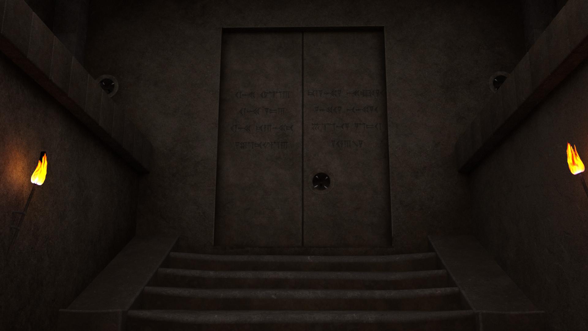

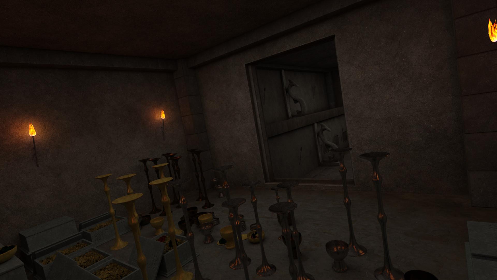

    And second, while I didn’t change the luminosity of the panels or the torches, I have no experience of how the whole place looked with its original ‘ghost lights’. That’s how the place looks from Camera 6’s point of view, with just the changes I spoke about in this message:

  • Thanks for all that - I've not had time yet to work with the new public build and the new ghostlights. Under the old system, setting opacity super low had its own issues so I used the black opacity map instead. this worked great until Nvidia "fixed" it. I also separated the fire colour layer from the emitter layer as too often a bright enough emission washed out the colours.
    For reference, the promo page shows renders of what it looked like with the old lights when they were working: https://www.daz3d.com/fantasy-trapped-vault
