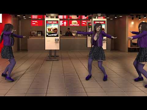

    I did a DAZ iray render with a background while I slept last night
  • IvyIvy Posts: 7,165
    3 dancing girls yeslaugh
