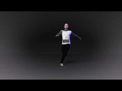

Back in the day I made this animation with Micheal 3 and just straight put the BVH file on it and it worked pretty good.  This was straight data from Optitrack.   Now I got to do flips and cartwheels.  Am I missing something?  Why would we be going backwards in animation and not forward?  I hope I'm missing something as I'm trying to find workarounds.
Literally took an hour worth of work.  Jump in the suit.  Dance around.  Put it on Micheal 3 Spiderman and an Iron Man suite for Micheal 3 and walla.  Now it seems like jumps, leaps, bounds and back flips and having to exit DAZ and use 3 or 4 other programs.  Is there any plugins to make this process easier.  Just surprised that the newer process is less efficient.

    My understand is it's because of the bizarre extra bones DAZ added to the new figures. No MOCAP data has these, and so everything goes screwy.
    P.S. This dance sequence is awesome!

    I like to dance.   :)
