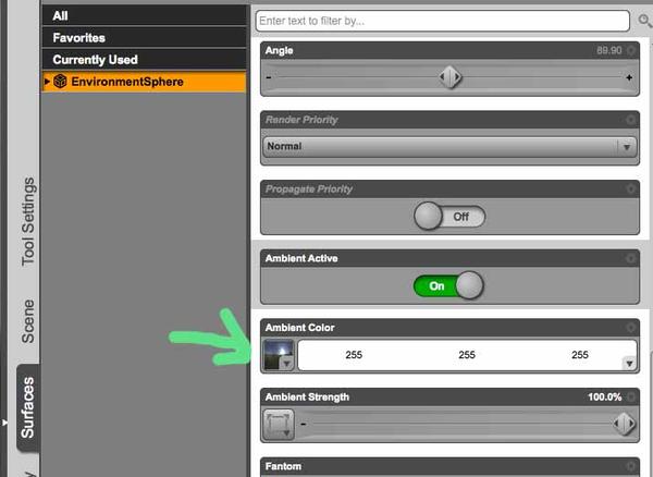

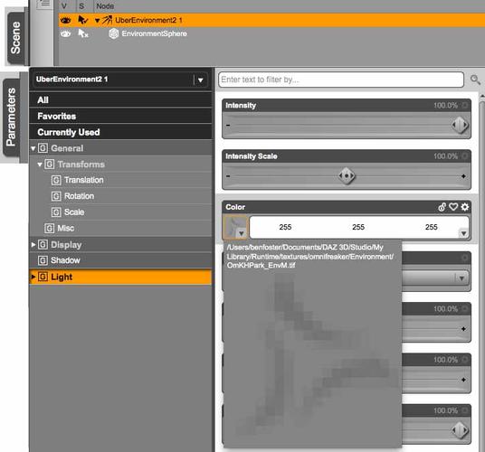

    If I'm understanding you right I believe its possible.
    You can either apply texture maps to the existing UE2 Light on both the Environment Sphere and the light.
    Or use an existing Skydome and apply the same map to a UE2 Light and Delete the environment sphere(Its hidden in renders by default.)
    You can change the Texture map for the UE2 light in parameters and the Surface map on the Environment Sphere in the surfaces Palette.
