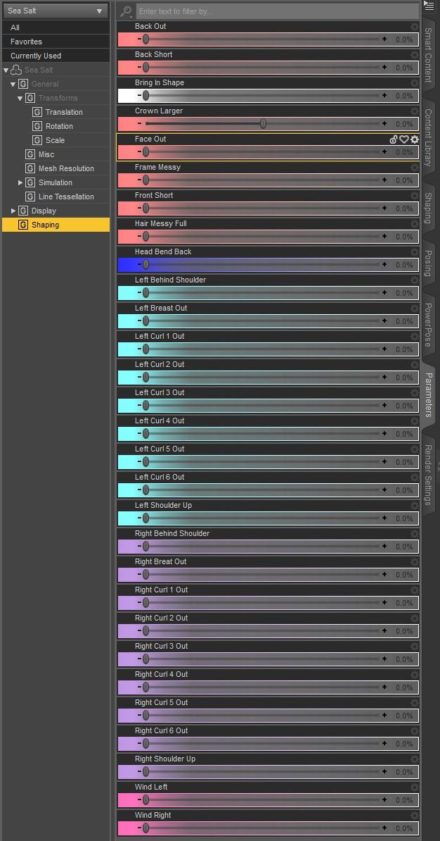

How do I use it?  Select your figure and load the model like you normally would.  Make sure that you do not have the geometry editor tool or the awesome Mesh Grabber Tool selected, pose your figure and render.
How do I use the morphs?  These SBH hair models are currently in pieces to add more versatility.  Selecting it in the scene tab will make the morphs appear in the parameters tab ( They are parented to the head) .  Keep in mid that because these hairs are separate pieces they are grouped.  So you will have to expand the options in the scene tab to find the individual pieces.  Then just play with the sliders to your liking!
How do I simulate the hair?   Welll there are several ways to do this,  but the easiest way is to click on the simulate tab and click simulate.  No extra settings needed.  You can also use a timeline animation, or use the settings provided to use just gravity.
There will be so much versatility!! I have added a ton of separate surfaces so you will be able to easily kitbash these.  Shut off certain surfaces to combine them with other SBH hairs orrrr maybe even combine them with some of the regular 3d hair models in the store and make a hybrid!

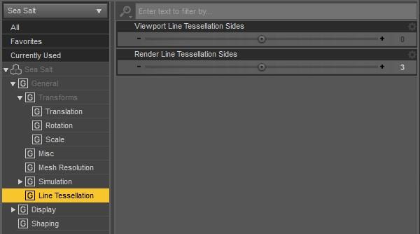

    If you find your hair is sticking to the body too much,  use the "Head Bend Back Morph".  before simulating.  It also looks so much nicer after certain simulations.
    Also.. I keep forgetting to add a special preset so that the hair is visible in the nvidia viewport. Sorry guys.. I honestly never use it.  So fo those of you that are struggling to figure out why its rendering invisble in the nvidia viewport:
    Click on the hair in your scene.
    Click on the parameters tab.
    Scroll down in the parameters tab and change the Viewport line tesselation sides  and change it from 0 to 3.

    There are two reasons its invisible.
    1: You are using the nvidia viewport ( which i apologized for not making a preset for that in the post above).. with directions on how to fix that
    2: You have the geometry editor or ManFridays Mesh Grabber stuff on. Just select a different tool .. like the active pose tool and stuff should show up.

    nvidia viewport? Ill look into that. Im certain that the geometry tool isnt selected and I dont have Mesh Grabber. I can simulate the hair just fine. The memory crash happens at render.
  • chevybabe25chevybabe25 Posts: 1,361
    I am attaching a picture of the nvidia option.  If you don't use that and its still rendering invisible, Ill have to ask tech and see whats up with that. There is nothing worse than buying new toys and not being able to use them.
    "Scroll down in the parameters tab and change the Viewport line tesselation sides  and change it from 0 to 3."
    OK, this fixed it. I shouldve read down further. The hair is now viewable in my viewport and renders without crashing. Its a bit heavy on the memory but thats just because of my out-dated video card. That nvidia preset would be nice.

    Yay! Glad we got that sorted!!!
    Those settings listed above are on the surfaces tab.  There are a lot of surfaces, so you will have to tweak each one individually ifyou are tempted to play with stuff.

    If you use the gravity option which just relaxes the hair into the current pose, (Start Bones From Memorized Pose.. OFF)  you should be just fine.
    And for best results lift the hair with the morphs provided before starting a simulation :)

    How do you change parameters like Root Radius and such? I didnt see those items in the parameters tab and when I choose edit strand based hair daz tells me that there is no strand based hair node selected.
